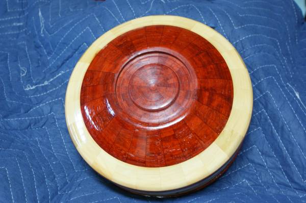

Earlier in this thread I posted a pic of a recently finished bowl. The bottom of the bowl is 24 segments which were cut using the jig posted by jerry Bennett on the segmentology website. The plans are free and the jig works perfectly.

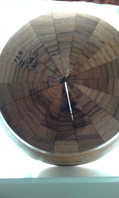

Be careful using segments on the bottom of the bowl, I have had them crack because of expansion. Not sure if the wood had too much moisture or not but I have three crack and stopped doing it.

Could it have been caused by different rates of expansion and contraction of the different woods? Just a thought.

Or grain orientation?wa2crk wrote:Bob Coates

Here is a picture, it is maybe 5 yrs old but been cracked for awhile. It is oak bottom and about 7 1/2 inches across.

I am curious what the grain orientation is on the glued sides of the segments.

I have no idea, assume open grain to open grain, too long ago. That is the way most of my segments are done.
