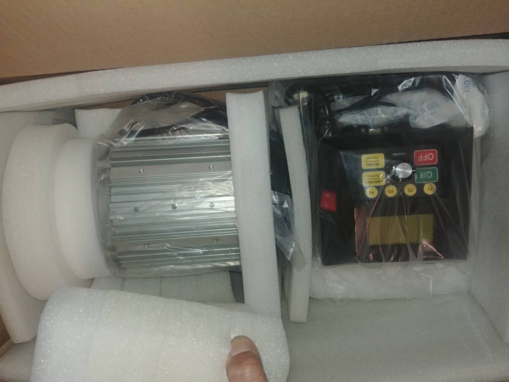

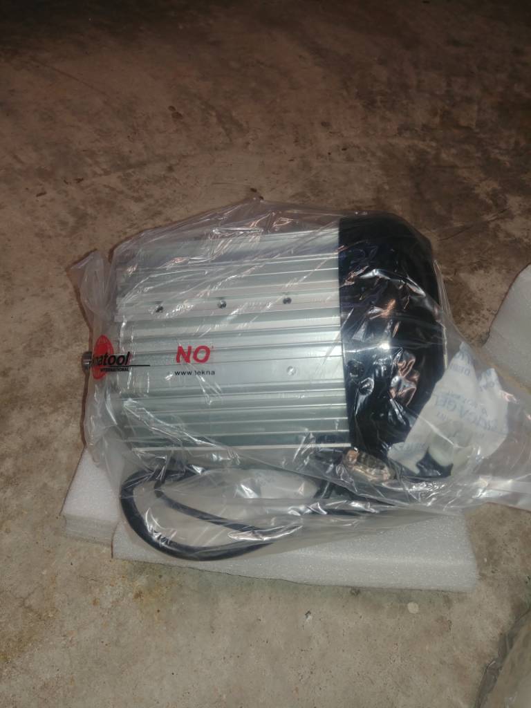

I just purchased Striatech/Teknatool motor and controller from Amazon for 550 USD.
I had $300 discount and basically my cost was only 250.
I will have to figure out how to install it but don't think it will be to complicated. Sent from my LG-H872 using Tapatalk
