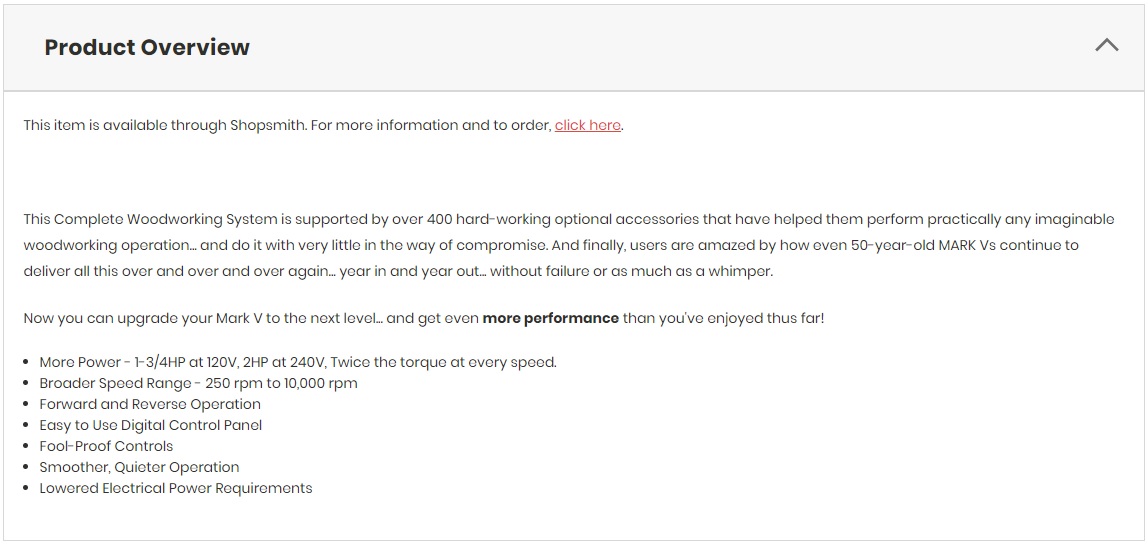

thunderbirdbat wrote:Striatech, the DVR motor supplier also list the DIY PP upgrade as being available from their store. Not sure if they are the manufacturer of the controller as well as the motor. https://striatech.mybigcommerce.com/
It is interesting they include it on their website now, but if you click on the description they just refer back to getting it from Shopsmith. It says "This item is available through Shopsmith. For more information and to order, click here." where the link goes back to Shopsmith. So, I don't think anything has change here for them. This is what the description says for it:
