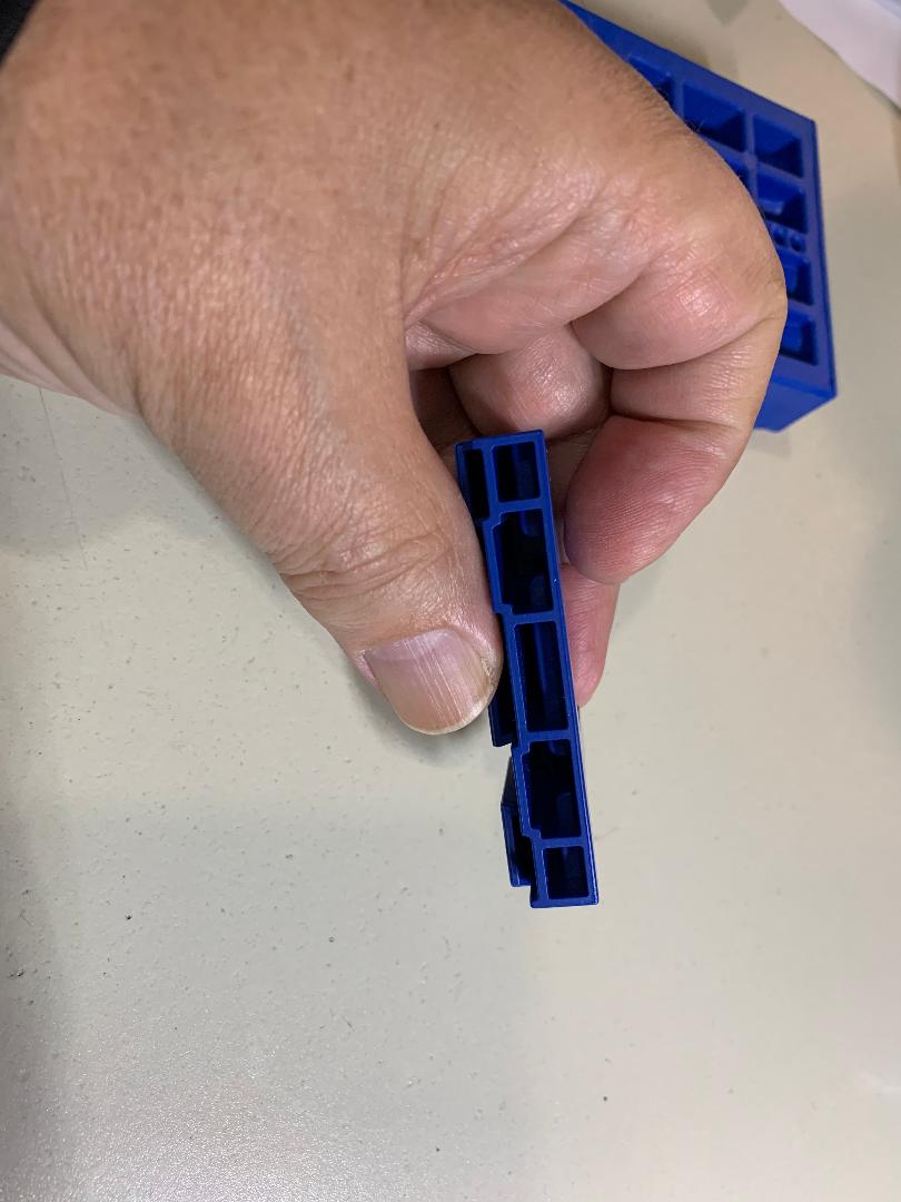

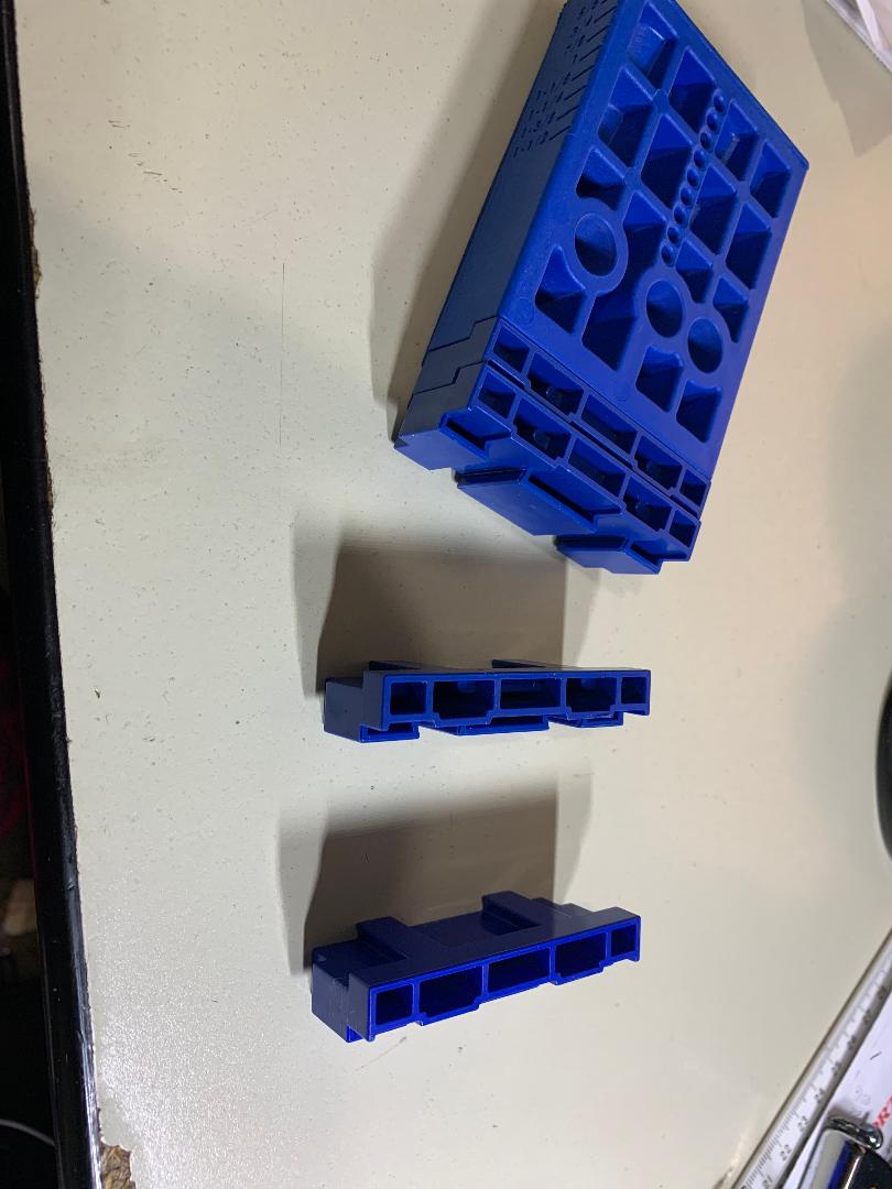

As you have been following along it is obvious that the material thickness needs to play a part in where the drill guide goes. For this application it is no different. To deal with this we can first look at the "base" of the jig where there are some dovetail areas.
So it is reasonable to think that something must fit in those dovetails.
They give you one of these spacers so you have no spacers being good for 1/2" materials and add the spacer for 3/4" material. If for some reason you need to have work with thicker material they of course sell more spacers. I ended up getting the extras but have never actually used them.

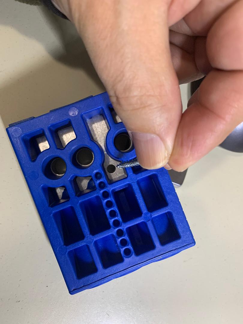

Now you will also have to clamp the jig in place. Any clamp that will fit will work but if you can't get a clamp on then there is another option. They provide a hole where a screw can be inserted, do be aware of that screws length unless it OK to add a through hole...

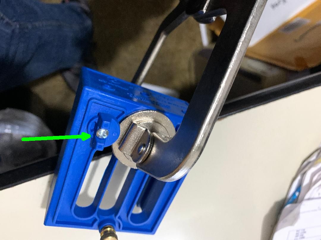

One thing I wanted to show is the interesting method kreg has to hold the clamp in place on the portable jig. The arrow points to the built in twist cam, there is another on the other side. Having the clamp attached makes it easier to use most of the time.

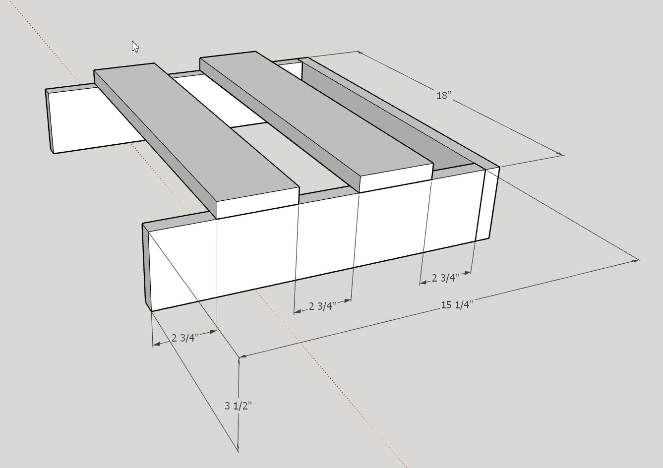

I had enough 1 x 4's to do the sides and back but not enough for the top. This is how I planned to make it:

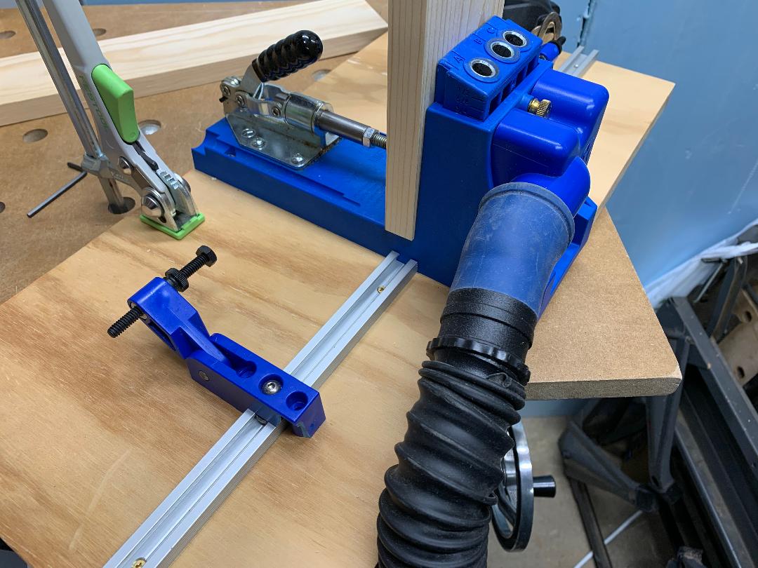

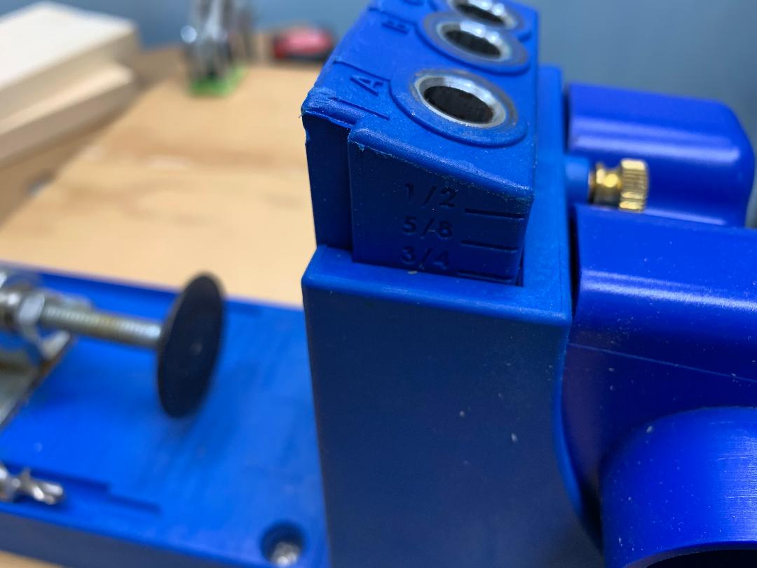

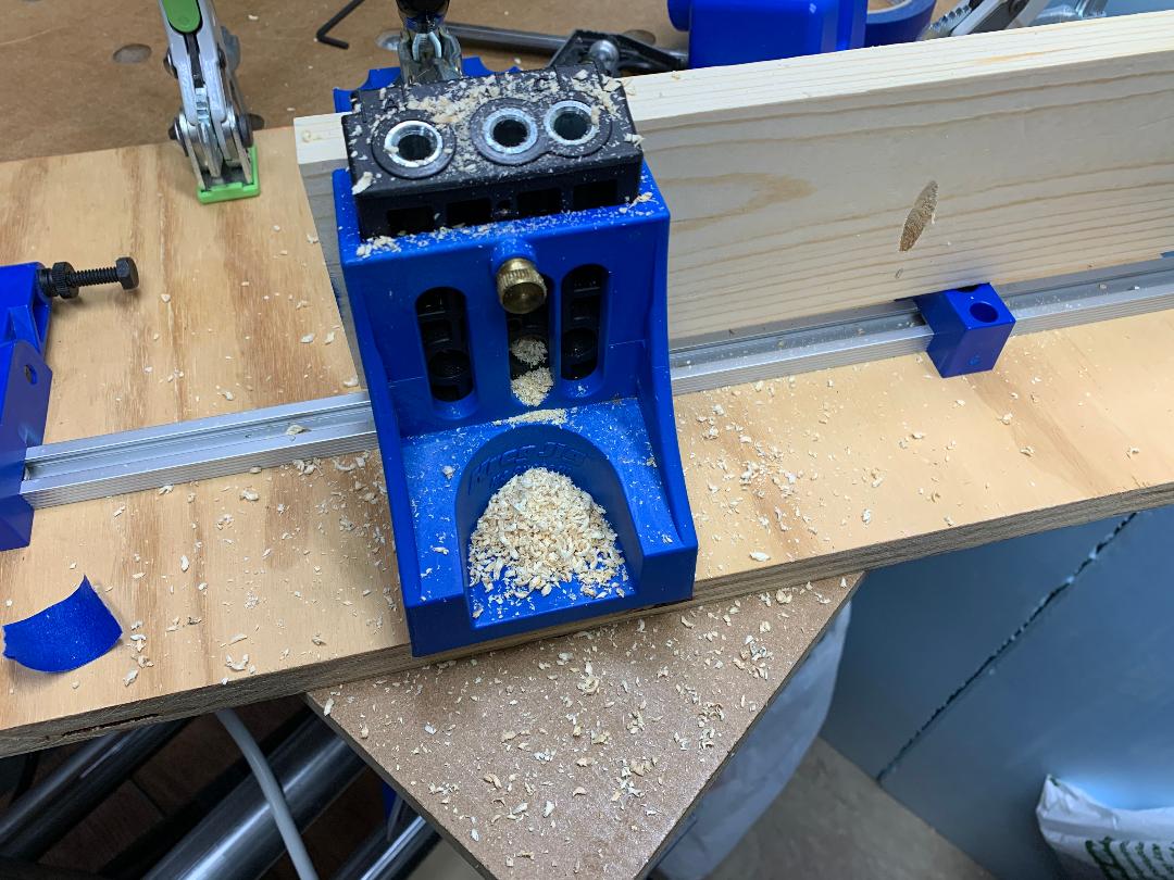

Now it's time to set up the jig, some of this will look familiar by now. The wood is 3/4" thick so the jig is set for 3/4".

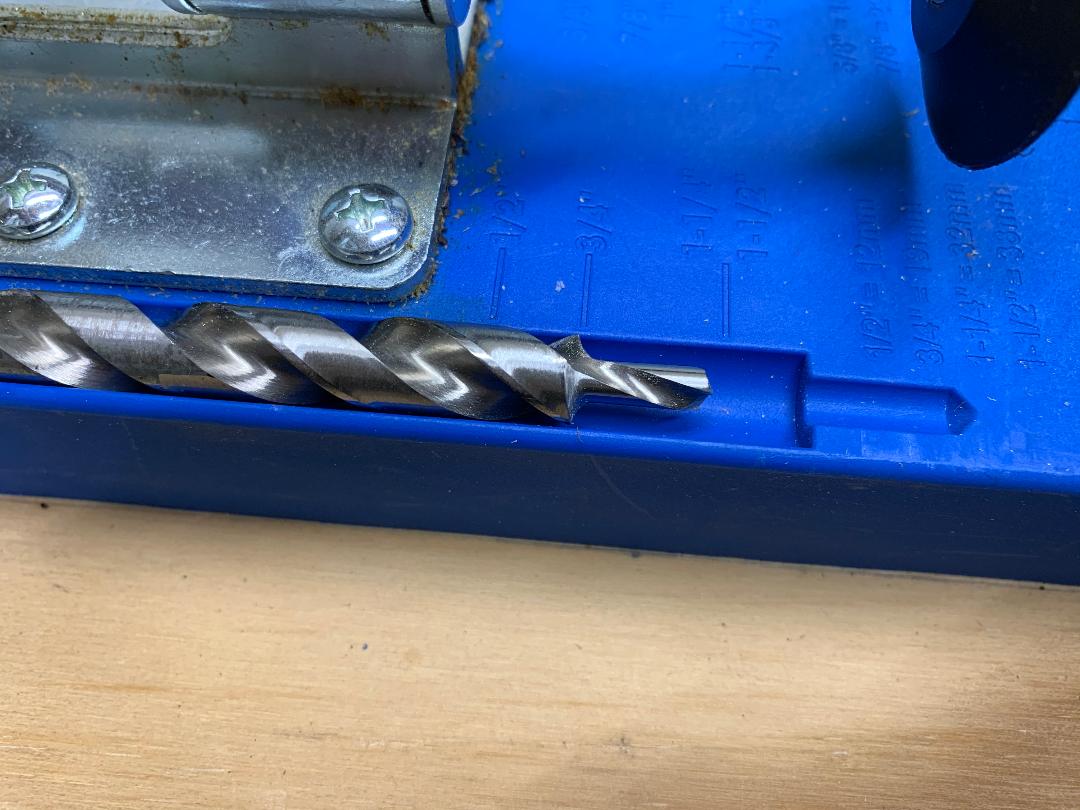

The collar is then adjusted for the material:
We haven't discussed this before but this jig also provides for chip collection. In this shot you can see it hooked up. You do end up getting some chips coming out the drill area but it does a pretty good job.

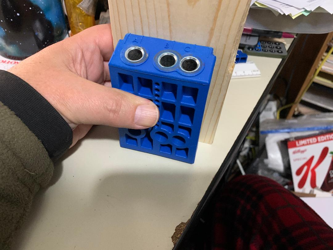

The clamp needs to adjusted so it holds the stock nice and tight. Then it time to make some pocket holes. You can measure to get the hole locations but it pretty easy to just align the stock to the jig. Since the stock is 3-1/2" wide I use the A and C holes on the jig.
The results:

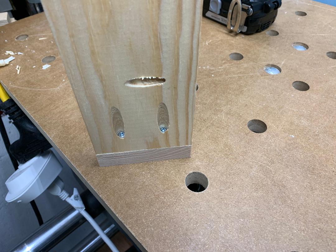

I had a piece of 1/2" plywood that was wide enough but not as long as I would have liked, but hey sometimes you just go with what you have,

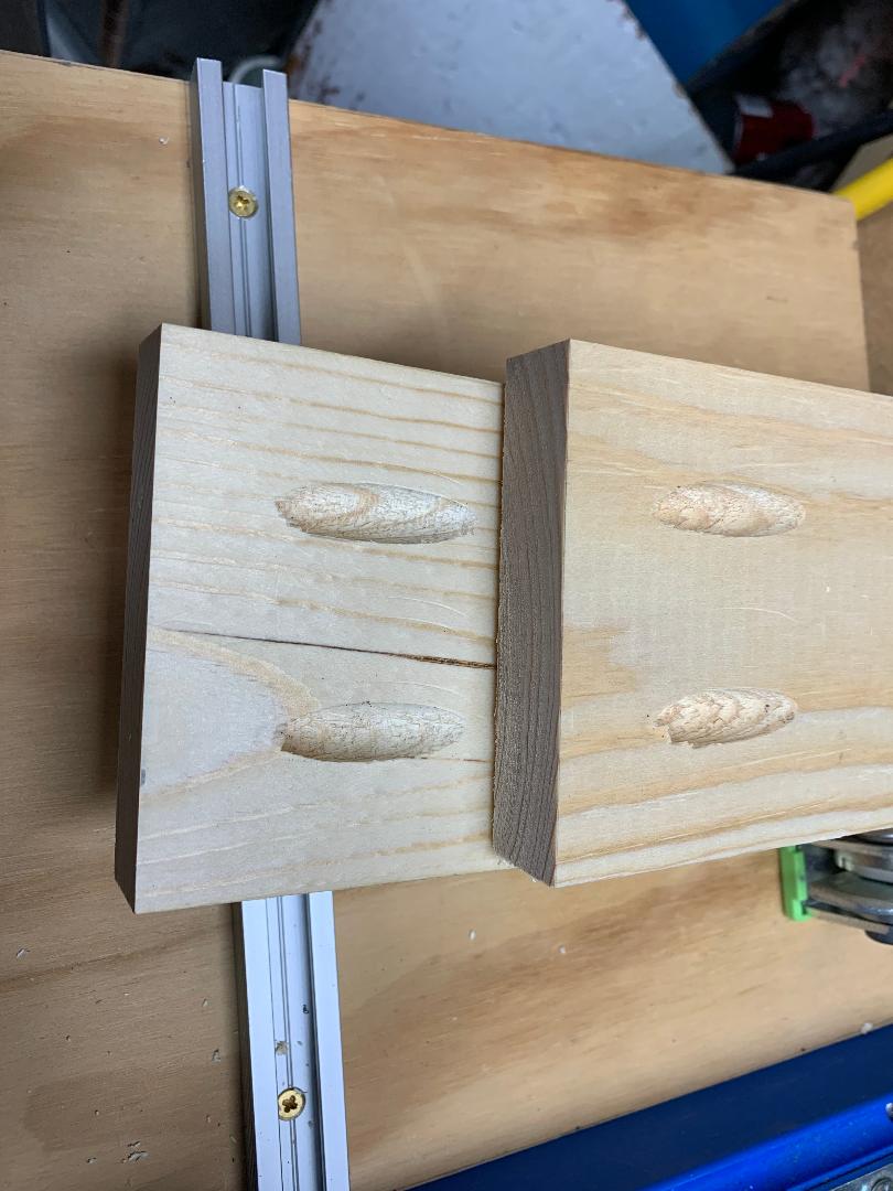

The same side parts that got the pocket holes will get the pocket holes to attach the top. Just because I can I switched to the micro jig. This way you can see the reduction on pocket size on a real cut. I did a set of marks that would result in having 3 pockets per side.
So you can see just how what happens if you don't use the chip collector this is the results of drill 6 holes with the micro jig.
Here is a shot of the the standard jig and the micro jig pocket holes.
These are the two pieces with all the pocket holes drilled.

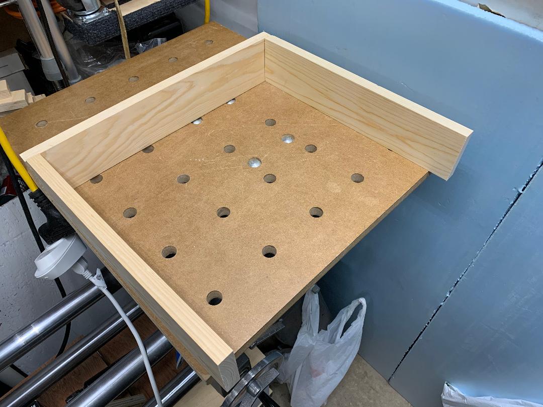

After installing the 4 screws it time to attach the top. Here you can see how I clamped it up to put the screws in.
Here is one of the pan head screws driven in:
Flip it over and make sure no screws have come through........ yep good to go.
Had I not been working on the post I would have just got out my nailer and put this together as it would have been faster but hey what I don't do for education.
