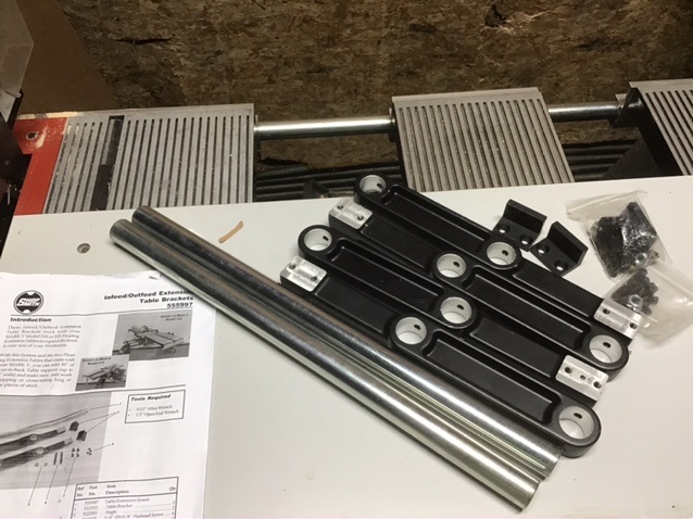

I got two Shopsmith a ‘82 MV 500 upgraded to a 520 and one I bought pieces off of eBay out too a M7. I got 6 floating tables, 2 end tables, and 2 main tables. I’d like to add 2 more floating tables and main tables down the road.
- E39BA046-98AE-4E71-A09A-C372D18BBC15.jpeg (116.75 KiB) Viewed 3659 times
- 3A8040A7-F439-4216-A686-36C376A132A6.jpeg (147.96 KiB) Viewed 3659 times

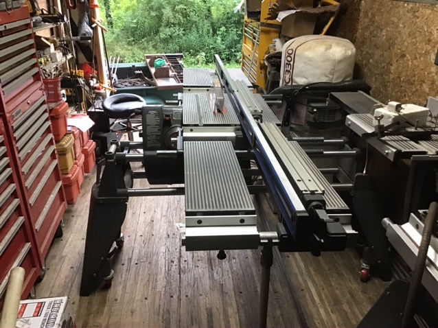

Re: Introduction
That is a picture of my SS before I built the dedicated shop in 2009. There are three 5' ShopSmith tubes and two 27" ShopSmith tubes.DLB wrote:If my starting point was 'I have this 510 but it is missing the connector tubes' I would be looking for longer 1" OD tubes to cut myself. I would probably make two at the 27" length, but I think if I had something between 36" and 48" that is what I would use most often. After you have four tubes you can grow into what else you would like as you use other setups, and possibly add regular and floating extension tables. The large table extension shown above with four floating and two regular extension tables looks like it uses three 60" -ish tubes.
I would use stainless, though I have nothing against the plated version that SS uses. I would go with much thicker walls, probably 0.120. (11 gauge, IIRC) That is especially important on long tubes for strength and rigidity.
Short tubes can also be useful. I have a pair of the 18" tubes as shown in the table extension pic posted above by SkullsquadronX and I use them all the time. But I sometimes wish they were 20" so I think that is the shortest I'd use if I made them myself. 18" will not make it through a main table and those extension brackets.
- David
I totally agree with the thick wall stainless idea. I bought two 6' lengths of 1" OD X .120" wall X .760" ID 304 Stainless Round Tubes online from Metals Depot. They are very rigid. I have four 5' Shopsmith tubes and they all have a very slight curve to them. The stainless tubes are very straight. I like the 6' length because if I have both fixed tables mounted I can add a floating table to the out board side of one of them.
