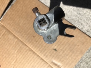

I have the 610 manual but my question is what is the blade angle from the top and bottom. Mr looks like there is an inches or two variation which seems off. The maneal doesnt give info on this. Any help appreciated.

I am not sure how you can get that much of an angle (1 to 2 inches) on the blade if it is assembled and aligned correctly. Other than a slight amount of angle that can be created by having the blade forward in one mounting block and back in the other mounting block the blade should be at 90 degrees from the table on both axis. Unless the angle is side to side not front to back. In that case check that the arm is properly seated in it's mount. The Arm should be at 90 degrees to the table. If it is front to back make sure the arm is all the way in it's mounting point and the upper head is all the way in the arm. The other cause for being off 90 degrees side to side is the table angle is not set correctly. These are problems that are caused by not being properly assembled or aligned.

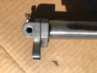

Had a problem with both but got the front to back one figured out but I have a left to right( looking at cutting edge of blade) of about 1/16 of an inch movement... not sure if that is a lot. When I tried a practice cut follows the line I drew ok but notice the blow for removing saw dust from the tube isn’t blowing. There looks like a gasket between the upper and lower section but looks like a press fit so don’t want try and force off if it’s not suppose to come apart. Sprayed oil in blow hole and saw it leak from gasket area so assuming that’s the issue.. again the manual doesn’t show any gasket or being able to separate. Again thanks for ideas. Will try to post pic
- 2101ABE9-703A-41FA-9DDE-F316342BEF70.jpeg (22.31 KiB) Viewed 9685 times

The other view
- 98F5BF06-C7E8-48BA-9180-ECCF92AE7389.jpeg (24.43 KiB) Viewed 9684 times
