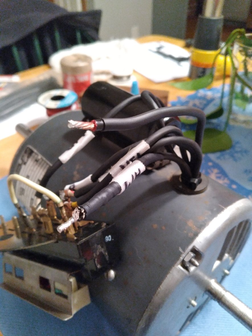

Ok, its back together and running great forward and reverse using the original switch, except for power wires. Can hear the centrifugal switch clicking off when powering down. Going to put the motor back into the headstock this weekend, then start thinking about the switch. The shrink tubing worked very well, and I appreciate the suggestion. One wire was too badly corroded so I clipped it back and soldered on a new wire. It wasn't as scary as i originally thought, watched some YouTube videos of people rewinding motors and realized that they aren't that fragile. Just need to be careful.
Thanks again, Mike

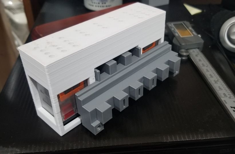

Brandon Ausmus
December 3 at 8:38 PM ·
This is the current prototype for 3D printed replacement ShopSmith Mark VII switch that I've been working on during 2020. This prototype is ready for wiring and it's first fitment test. However, it's still missing a few key components, like the lights for the buttons.
This design includes modern safety features like auto reset if the power goes out, a snubber network to protect the switch from voltage spikes (which is what kills the original switch), A WARRANTY, and will be completely user serviceable!
The original goal was to keep it around the same price as a used one on Ebay (~$100), but that might not be possible. I think the price point will likely be closer to $150. Theres still some robust testing and final validation/verification to do, but when it's ready, I'll be making 20 of them during a low-rate initial production.
I don't expect them to fly off the shelves, but I intend to keep a handful in stock for anyone that needs one.
(It will be available in black, I'm just using cheap filament and low printing resolution for prototyping)
Additionally, if you own a Mark VII with an original working switch, I'll also be selling a snubber network addon to help protect it from further arc fouling.
I'd love some constructive comments and questions!

Brandon Ausmus
Mike King
it's probably the holes on top that give it that vibe. The wiring goes through them to wire up the relays and switches. Once that's done it'll probably look more like Predator, lol.

Geoffrey Baker
badge icon
Very cool. But I hate to tell you, you've made it too large. But when you scale it down I'm sure people will pay over $100 for a new, working, improved switch!
How about designing a new plug in replacement for the main circuit board for the variable… See More
1
· Reply
· 1d · Edited
Brandon Ausmus
Geoffrey Baker
I believe it isn't too large. There should be enough clearance between it, the way tube, and the motor, but I won't know for certain until I get my headstock pulled apart and I get it installed, which is the next step.
· Reply
· 1d

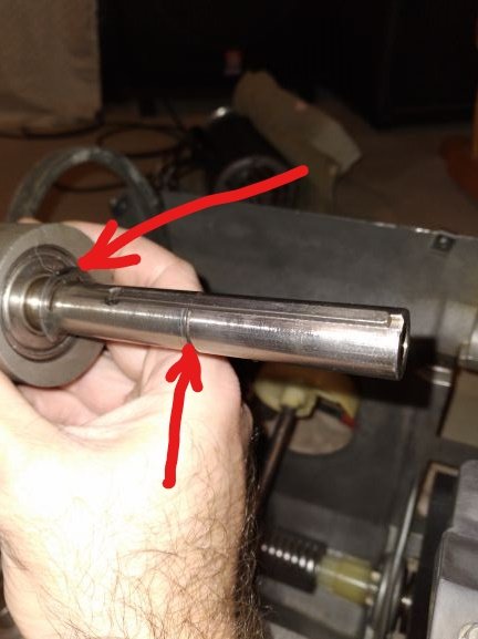

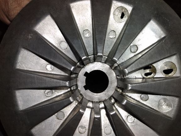

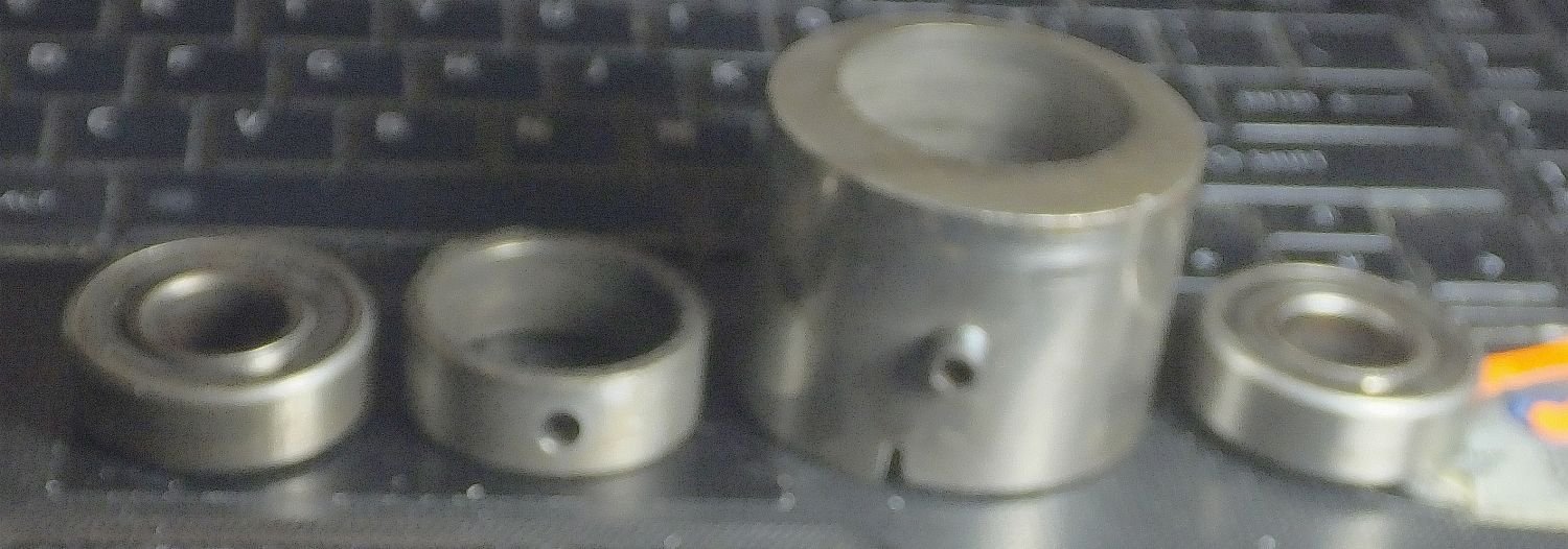

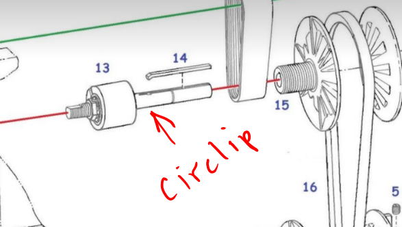

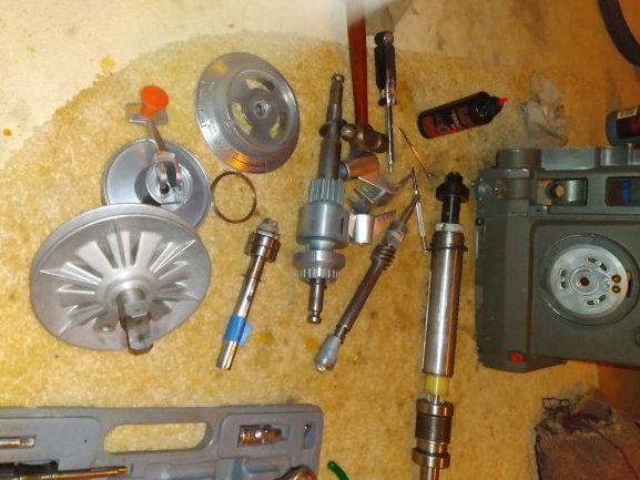

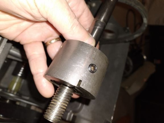

Ok, so I thought I would be happy just to get the motor running, but I can't just leave the headstock all gummed up. I took everything apart, cleaned, oiled, etc. I have reassembled and it operates amazing, without the motor that goes in soon.
I have a couple questions,
What is the set screw in the eccentric used for? It doesn't appear to contact anything between the two bearings?
There is a circlip just behind the eccentric that is not shown on the MarkVII parts diagram.
There is a groove in the sheave shaft but no clip, none shown on the parts diagram either, why is it there?
Why two keyways in this sheave, only one fits with the key. Perhaps made to fit multiple units?
Is there a method to tighten the ribbed belt/eccentric, or just tighten until it doesn't slip. I don't see any instructions in the manual.
Thanks, Mike -
Thanks, Mike -

Re: New member, not sure where to start.
Yes the circlip belongs in the inner groove to act as a bearing stop.
The second groove is a mystery.
There should be a spacer between the two bearings with a small hole that the cone point set screw secures in position.
