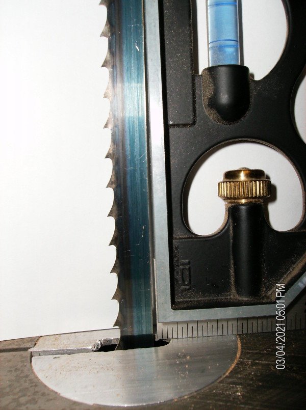

My bandsaw is 40 years old this year so it has the cast iron table and no shims or washers of any kind under it. That would be the way it was assembled back in 1981.
My blade has a bit of angle as shown in this picture.
I've used it only for resawing so I have not encountered any situations where that angle makes a difference. I don't use it for any scroll type work or cutting around corners. I have a scroll saw for that work. If I ever do any cutting of curves, I probably might shim the table to get it at 90 degrees.
