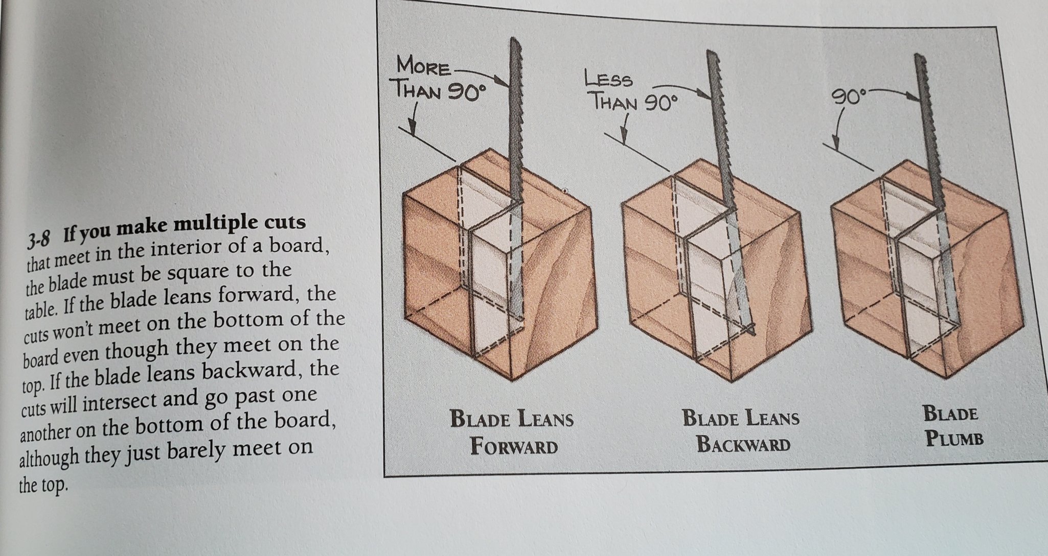

You don't cut curves with a handsaw.
The issue is when cutting curves in thicker materials, the walls are not perpendicular. For me that would be puzzle and bandsaw boxes.
Regarding blade thickness changing the angle. This is true to an extent. However I will not be cutting accurate circles with my 1/2 and 5/8" resaw blades. I have trued my table to a 3/16 blade, and verified that the 1/8 and 1/4 are also square.

It is very important if you use the band saw to cut tenons.
paulrussell
Posts: 675
Joined: Sun Apr 11, 2010 10:35 am
Location: Dewitt MI
Re: Bandsaw Table Installation and Alignment
Post by paulrussell »
jsburger wrote: Sun Feb 28, 2021 1:22 pm
Yes.
And another example from Nick Engler's book "Using the Bandsaw"
