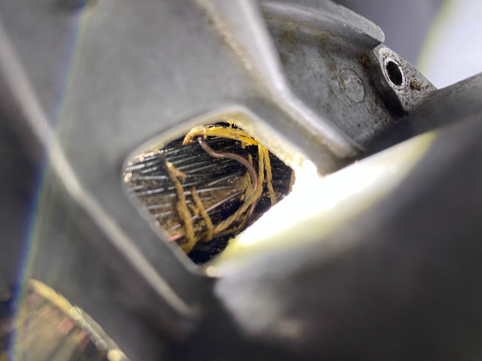

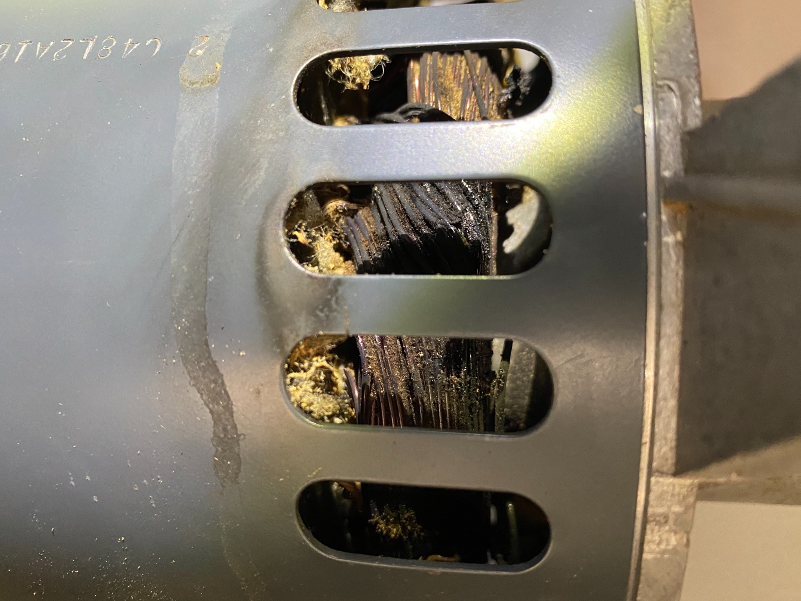

DLB wrote: Fri Mar 19, 2021 5:56 pm Remember not to apply power for long, if there is a start problem then the run windings are getting hot and this can lead to worse news.
If your circuit breaker is tripping almost instantly when you turn it on that is more likely a short circuit, either in the motor or external wiring. If it takes a few seconds to trip that is more consistent with the start circuit.
I don't think you are ready for this yet, but very good used motors go for under $200 on eBay. You might also look locally and avoid the shipping. And some people here might have one, so let folks know where you are if you get to that point.
All bearings move freely but not smoothly...
Speaking of windings getting hot, I did notice that the wires were black/charred/fused together in some places and broken off in others... I’m guessing this isn’t a good sign?

That motor is toast. You need to replace it. They do come up on eBay all the time but be careful.

That’s what I was afraid of... it sounds like between a new to me motor plus the parts that are missing it’ll end up costing a bit more then I want to put into it. If I needed it to function more then just a lathe it would probably be worth it, but since that’s all I would be using it for I will probably just pick up a HF lathe to putz around on. Thanks for all the help guys, if you see anything in the photos that you could use or want send me a message, I’m located in central Ohio but travel frequently around the Midwest.

Wow, that sucks. Sounds like the motor shorted. No telling why that happened, I have run across those on used machines, yet there are motors from the 50s still running.
