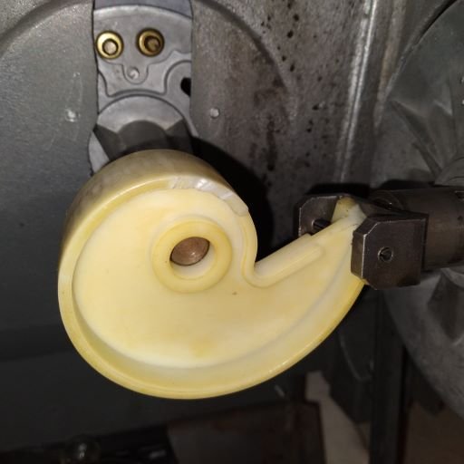

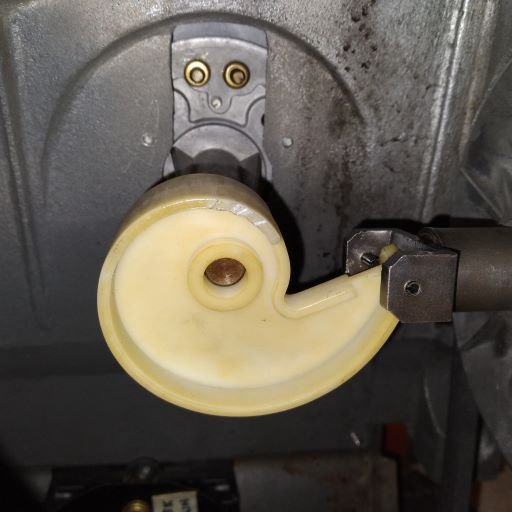

Ok, the picture below is the speed cam with the washer installed. There is a bit more cam end visible than without washer (bottom picture), which makes sense. I removed the washer and I am back up to about 825 RPM. The washer was 0.156" thick (my mistake previously estimating 1/8" thick).
So to summarize; the 0.156" thick washer will drop the RPM about 110 RPM without any other changes. I can't explain it. Maybe because I am effectively only adding belt width to the top pulley that somehow makes a difference?
I don't think I am really adding 0.156" to the width of the belt because when I add the washer I can't really get the speed cam rotated to the exact same spot (detent), so maybe the difference is the washer thickness minus the distance between detents? Complete guess. :)
Interesting puzzle. :rolleyes:
Hopefully, I can just find a 14mm X 750mm belt.
Mike -

What is puzzling me is the speed control appears to have been moved also????
miken
Posts: 253
Joined: Sat Nov 14, 2020 10:28 pm
Location: Maine
Re: Mark VII Low Speed Too Fast
Post by miken »
Yes, my mistake, I forgot I moved that bit between that bottom pic taken yesterday and the top pic from today, but the results from today still stand. I haven't rotated the speed control since I took the top pic with the washer installed, and the cam looks pretty much the same now as the bottom pic from yesterday with the washer removed. Will add a new pic without the washer shortly.

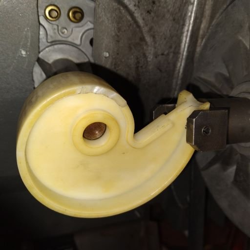

Yes, I have searched a little and haven't found anything yet either. I have a clausing lathe belt that measures 0.51" but its 36" long, and still not wide enough. Maybe clausing has some other options? I appreciate your willingness to go through this again, but I am thinking that my options are limited on this one. Either find a belt that works (trial and error), use a washer on the backup headstock and let the belts run slightly misaligned, or just forget about it. I can say that after seeing what 710 RPM looks like I do like it a lot better than 820. I may still make the idler to protect the plastic gear rack. Maybe I will go back to considering a version of the speed reducer Scott Markwood builds here: https://www.youtube.com/watch?v=5ZNIDkewy0U
Below is a new pic of the max'ed out speed cam with the control dial thing in the same location.
Appreciate the help JPG.

That 710 rpm? Looks very reasonable. How about dial calibration? How about other end(fast)?
