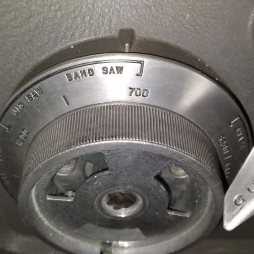

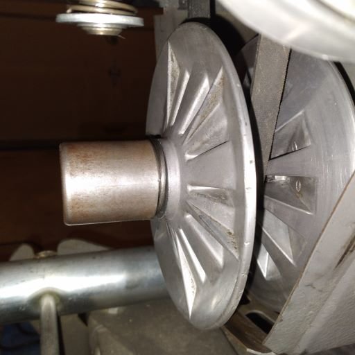

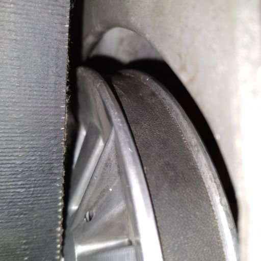

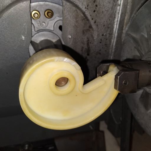

Hi all, hoping to get some advice on my Mark VII speed control. FYI, I measured my RPM using a vintage Starrett 104 RPM meter, so it is not a precise RPM measurement. I have tried to verify accuracy some by testing it against my metal lathe at a known RPM of 805 and I read 815 or so. The lowest RPM of my Shopsmith is around 810. I am in the process of putting my second headstock back together so I can test against that as well.
I am trying to figure out if the plastic speed cam looks like it is set properly for the lowest speed, or if the end of the cam (largest diameter) should be closer to the button bearing thing in the pictures below. Also note that I have one detent left on the speed dial, but it wont stay in that position and clicks to the second to last detent automatically. That is to say, the bottoming out roll pin is not in contact in the slot behind the speed dial. I am also attaching pictures of the V-belt at 700 RPM in the top sheave. I don't think it can really go any higher in the sheave as the bottom (motor) sheave spring is pretty much fully compressed. Also, I have two v-belts that appear original and they both measure 30" O.D. I have read that 29.5" is supposed to be correct for Mark 5's, but I assumed the same for Mark VII's, mine may be stretched? Not sure if they can stretch 1/2" though, or if a longer belt equates to higher or lower RPM.
I am not really sure where to start on this other than if the speed cam does not look right (I think rotating it further (clockwise in the photo) towards the end of the cam would cause a reduction in speed) I could try to loosen the 3 screws on the speed dial and turn it a bit. However, I really think I am limited by the compressed motor sheave spring?
Thanks for looking, any help is greatly appreciated.
Mike -
Mike -

Have you tried to rotate the entire speed control? The three screws/slots allow doing that. The bullet detents IIRC do not cover the entire range(may have only one detented at the extreme(700/5200)speed settings).
The high speed setting procedure is completely different from the mark 5/V.
What is the part # on the two OEM belts? How wide are they at the widest? Narrow belts will cause higher speeds.

No, I haven't tried any adjustment of the speed dial yet, was hoping for confirmation the speed cam didn't look rotated enough. Can you explain the MarkVII high speed adjustment to me? The OEM (I am only assuming OEM) belt number is 501330 and it appears to measure 1/32 under 1/2 inch wide (15/32 inch).JPG wrote: Tue Sep 28, 2021 4:36 pm Have you tried to rotate the entire speed control? The three screws/slots allow doing that. The bullet detents IIRC do not cover the entire range(may have only one detented at the extreme(700/5200)speed settings).

I think the cam needs to be rotated more.

15/32 is a too narrow belt. Makes speeds slightly high. Makes belt seat further into the pulleys.

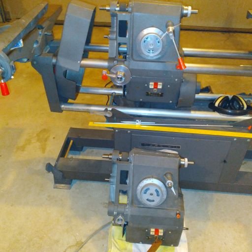

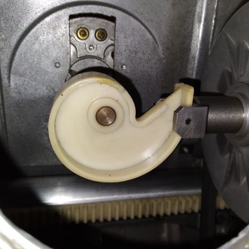

Well, I threw the backup headstock back together, and even though the dial reads 700 and the speed cam is clearly rotated more (I would say that's scary max'ed out), my reading was actually 10 RPM faster at 820. So, it is very possible my RPM meter is way off, it is likely older than the Shopsmiths I am measuring. Or as you mentioned, maybe it's more about the V-belt. I do find it odd that both machines have matching 30" belts.JPG wrote: Tue Sep 28, 2021 8:03 pm I think the cam needs to be rotated more.

I have had this D&D PowerDrive 29.5" in my Amazon cart and think it was the one recommended in a past post. https://www.amazon.com/gp/product/B01AG ... 0DER&psc=1
Shorter equals slower so that's a place to start. I will try the 29.5" first and see what happens. I don't think there is much I can do about the belt width as you know from past posts, they advertise 1/2" wide, but fall under that. I wonder what style the OEM belts are, 3L, 4L etc. Did you finally land on a belt that you thought was best? I know you were trying a bunch of them. Were you testing for RPM or just fit?
This isn't a huge problem for me, was just hoping to slow down the jig saw a little. I don't think it's really worth chasing 100 rpm's down a rabbit hole, but it's worth trying a 1/2" shorter belt to see what happens. Sad that Shopsmith basically abandoned these machines and their owners to only the similar Mark 5 parts, but that's business for ya.

I could never get my mkVII to go below 800RPM either. I believe I have an OEM belt (29.5" ,IIRC.505" wide). I also tried the exact top cog belt that JPG recommended; it made it worse (it was slightly less than .500" wide).

I think one possibility (being a plastic guy) is that over 50 years the plastic nylon cam has shrunk (especially if it was molded in a cold mold which it probably was). that causes nylon to shrink over time. This would not push the sheave as far as before ; not being able to slow to 700RPM. Again, I don't know this has happened; just a possibility.
