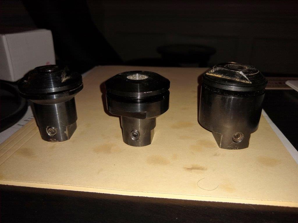

I don't think this helps-but someone with cross compatibility of arbors between models will know. I'm nearby you HopefulSSr and have
a number of arbors that came with my tool- attached to some questionable blades I never used. My tool is a 520 model.
I believe the one on right is 555608 5/8" Arbor for models 520, 510 and 505
The one in the middle I think is a 555130 1 1/4" Arbor for Shopsmith blades for models 520, 510 and 505
The one the left - I don't really know !
But it is 5/8" .
Let me know if one of these can help you-
b

A word of caution. There are two different 510/520 5/8" saw arbors, the one on the right is for sure the later/current one. There are also some non-OEM ones that look like the early version. This thread has great detail on arbors of all kinds: viewtopic.php?p=260771#p260771 (See the PDF) The most reliable way to distinguish 500 (or pre-500) arbors if unsure is to measure. My best guess is that the arbor on the left is the early 510 5/8" or non-OEM 510/520. One could probably get away with this on a Greenie for a test, but IIUC it wouldn't be compatible with the saw guard.
