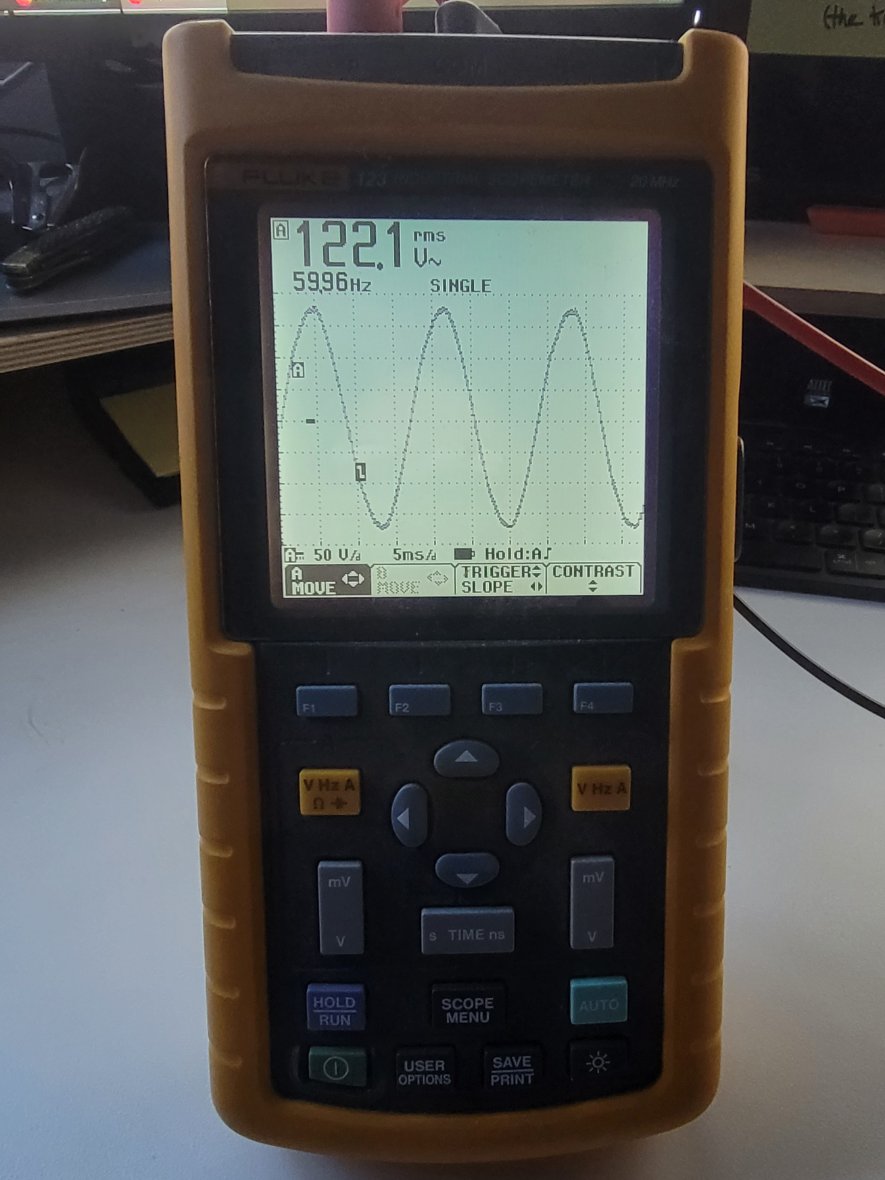

Hobbyman2 wrote: Mon Jan 24, 2022 10:17 am
JPG wrote: Sun Jan 23, 2022 11:54 pm A digital meter does not lend itself to transient fluctuation indication.
The old fashioned kind would be better(d'arsonval movement).
The first link and voltage meter with a needle would be a analog meter ? sort of like the old automobile volt / amp gage , I use a digital meter like the 2nd link for radio repair , I use it for monitoring DC voltage . I can monitor line voltage from the power supply as well as power consumption in all radio operations , especially when in the transmit mode , they do have their limitations but are also very compact and easy to install . the 2nd link is a AC operations monitor .
I was thinking more along the lines of these understanding that most will not have a scope meter. The old Simpson 260 has been a work horse for many years and has survived a lot of rough handling. A Simpson 360 would do the job as well. I most frequently chose the Fluke 189 (especially in the woodshop).

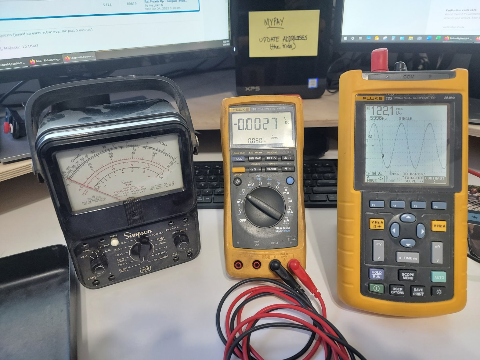

dusty wrote: Mon Jan 24, 2022 10:55 am
Now I got ya ,,, I was thinking more in line of incorporating something a little more permanent . I have a field piece meter set up that I have had for many years when I was working in the trades , that has also served me well , temp sensors , cfm . clamp on amp meter , C02 detector and so on that all work with one meter . trouble shooting a non working motor could require a lot of detail , most all of these meters will help ?
