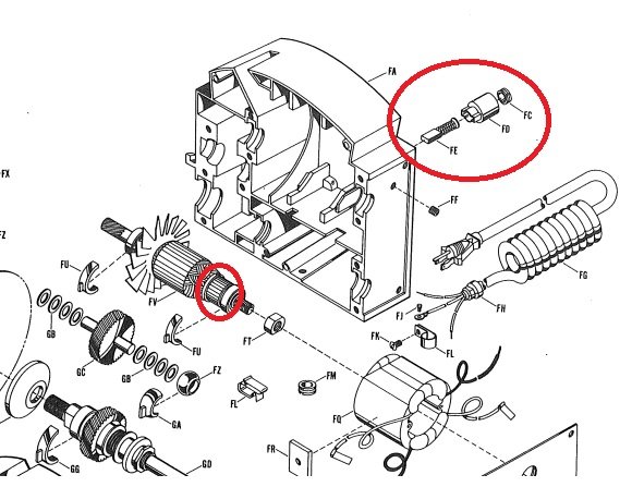

The easier version is that it is not possible to produce 2 HP on the stated input power. But that IMO it should still produce respectable power capable of ripping a 2X on 115 V at 13 A. It's going to produce maximum power at 13 Amps, and we don't know if it is ever drawing 13 Amps. One possible explanation of not drawing 13 Amps is carbon buildup between brush and commutator, which is normal on a brushed motor and occasionally needs to be removed.lahola1 wrote: Wed Mar 09, 2022 8:45 pm DLB, I only follow about 1/2 of what your saying but that's ok. This is what's so good about this forum. I've learned more about the intricacies of electricity following this forum for the last 5 years than my 1st 65 years.Thanks for all the input.

Here is a pic clipped from the manual Ed posted with the commutator part of the armature and one of the brushes highlighted. The manual says the brushes should be inspected regularly and replaced if worn to approximately 1/4 inch in length. I don't see the other brush in the diagram but it will be directly opposite the one shown. I withdraw my previous recommendation of a spray on the commutator unless the bearings are sealed type and you can keep the spray away from any gear grease. It would be better to remove the armature and clean the commutator. If you have to use an abrasive it should be a mild one.

DLB, thanks for that info. I'll inspect the brushes when I get a chance. I'm wondering, if I need to replace the brushes where would I get them?

CarbonBrush.com has a huge selection of commutator brushes. Even if you can't find your exact make/model, you may be able to match your existing brushes by style and dimensions.lahola1 wrote: Fri Mar 11, 2022 11:53 am DLB, thanks for that info. I'll inspect the brushes when I get a chance. I'm wondering, if I need to replace the brushes where would I get them?

First, I think it's very likely the saw uses a standard armature and compatible brushes are available. Since your saw runs it's probably just the carbon brush material itself that is worn down and that can be replaced with a standard or modified part. A motor shop may be help you find the parts or customize something for you.
