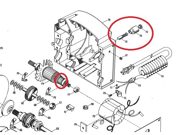

Here is a pic clipped from the manual Ed posted with the commutator part of the armature and one of the brushes highlighted. The manual says the brushes should be inspected regularly and replaced if worn to approximately 1/4 inch in length. I don't see the other brush in the diagram but it will be directly opposite the one shown. I withdraw my previous recommendation of a spray on the commutator unless the bearings are sealed type and you can keep the spray away from any gear grease. It would be better to remove the armature and clean the commutator. If you have to use an abrasive it should be a mild one.
RAS Parts Diagram
RAS Parts Diagram
RAS Motor.jpg (60.68 KiB) Viewed 1003 times
- David

DLB, thanks for that info. I'll inspect the brushes when I get a chance. I'm wondering, if I need to replace the brushes where would I get them?

lahola1 wrote: Fri Mar 11, 2022 11:53 am DLB, thanks for that info. I'll inspect the brushes when I get a chance. I'm wondering, if I need to replace the brushes where would I get them?
CarbonBrush.com has a huge selection of commutator brushes. Even if you can't find your exact make/model, you may be able to match your existing brushes by style and dimensions.

First, I think it's very likely the saw uses a standard armature and compatible brushes are available. Since your saw runs it's probably just the carbon brush material itself that is worn down and that can be replaced with a standard or modified part. A motor shop may be help you find the parts or customize something for you.
ETA: Great link from BuckeyeDennis!
