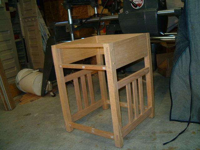

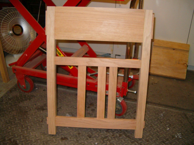

Hi, dlbristol! Yes slots will work just as well as mortises. Yes, the fillets between slats always take some fitting. However I've found fillets is also a good way to go.
Excuse these descriptions - I'm thinking while typing:
It is entirely up to you if you want to under-fill the slats. You would be able to under-fill all except the last slat. Then the last fillet would not fit vertically and would have to be tapered, or mitered in order to slant it into the groove. This is IF you make all of the fillets fit tightly up against the tenons.
Another way to under-fill is to cut each of the fillets a little short of touching each tenon. That way, you will be able to slide the slats sideways so the last fillet will fall into place.
All of that said - fillets without under filling (in other words straight sides on the slats) might be easier. The only vertical slats I have done into a slot were in Craftsman tables. There were only three straight slats per side and they fit into a stopped groove. Pictures below. I found that small clamps on each fillet closed any gap there was between the sides of the groove and the fillet.
The names of the photos kinda explain what's going on.

Thanks, I think that I will stay away from the under cutting, and just flush fit them. Thanks for the pictures, they are pretty much what I am trying to do. just more of them, and one wideer one in the center. Learning a lot on this project, and very glad I have willing helpers! I feel like I may have learned enough to ask better questions anyway. I'm still thinking on the procedure for fitting the whole assembly together, but thats a question for another day.
Dave
dlbristol wrote:Thanks, I think that I will stay away from the under cutting, and just flush fit them. Thanks for the pictures, they are pretty much what I am trying to do. just more of them, and one wideer one in the center. Learning a lot on this project, and very glad I have willing helpers! I feel like I may have learned enough to ask better questions anyway. I'm still thinking on the procedure for fitting the whole assembly together, but thats a question for another day.
Had another thought - Since you are going to be putting many vertical slats in I'm thinking you should undercut several of them toward the center of the head/foot. My thinking here is, the collective expansion/contraction of many slats might get appreciable. You can cut tenons on the several center slats in order to later install under-cut fillets that leave a 16th inch on both sides of the tenons. This should give the slats some small amounts of expansion/contraction room without any cracks showing.
Concerning the assembly - First glue up the posts and the bottom rail, While the top of the frame is "DRY FIT" and making sure the posts are square. If the top of the frame fits into the sides to make this impossible, then loosely fit the slats into the grooves and glue up the four corners. Of course you would first want to dry fit the whose assembly to figure out how your clamps will fit and make sure all the parts fit squarely and snugly.
