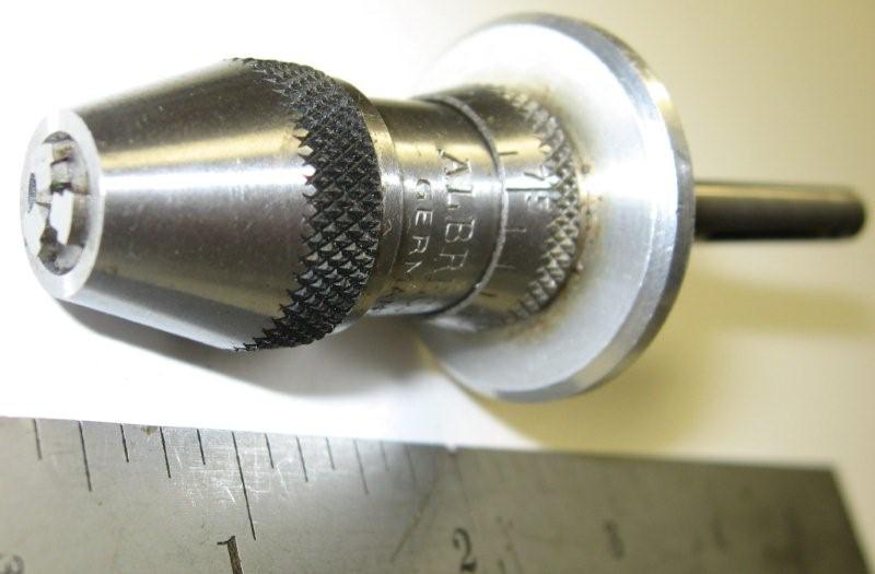

horologist
Posts: 431
Joined: Sat Dec 22, 2007 6:36 pm
Location: Melrose, FL
Post by horologist »
I have had mixed results with the pin vise mounted in the Jacobs chuck arrangement. In general the accumulated errors can wreak havoc on both your work and the drill bit. Chinese pin vises will not work here! I have an Albrecht sensitive feed chuck (missing the outer sleeve) that I use. These chucks appear regularly on ebay with a 1/2" shaft. This would probably work well with the 1/2" router bit chuck. For holes near 1/16" it really isn't that critical and odds are a Starrett pin vise would rarely give trouble. I frequently use the wire gauge bits between 61 and 80 and have pivot drills down to 0.1mm (0.004").
[ATTACH]3179[/ATTACH]
