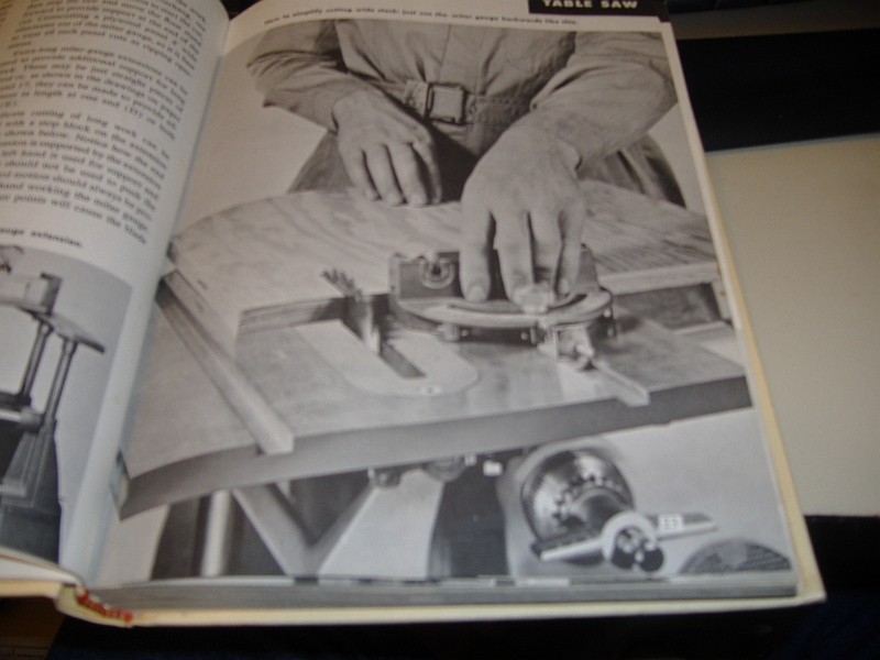

perryobear wrote:...1. The old (1955) edition of PTWFE shows a technique of turning the miter gauge around (using it backwards) when cross-cutting wider boards. It includes the following text and a full page photo:
&#8220]photo[/I] opposite page) increases the available table length somewhat, because it eliminates the space needed for the miter-gauge head. With this method a board 12” wide can be cut with ease.”
Question: I would never have thought of doing that with my miter gauge. Do any of you ever use this method? Do you think this method has been edited out from the later editions of PTWFE for reasons other than maybe just saving space?

First - I don't believe I would ever think of using the miter gauge backwards. That said, Only if the tail end of the piece were firmly clamped (affixed) to a fence extension would I even consider it. If the tail end of a board being cross cut ever drags away from the miter extension, the tail end of the saw cut would press on the saw blade, causing a crooked cut or worse. A MUCH better choice would be to use a sled.

Sometimes I guess you need to bend the rules a bit and for educational reason post a picture from an earlier version of the book.
I'm not really sure what people are picturing for how the backwards miter gauge idea works and for that reason I want to post an image of just how it does work.
[ATTACH]3345[/ATTACH]
Keep in mind the small table and the small piece of wood... you are only trying to gain a small advantage, if you have one of the earlier manuals take a look at the section (smaller lighter yellow cover one it is on page 23, a squaring board is shown used the same way on page 27).
miter gauge backwards.jpg (319.49 KiB) Viewed 5750 times
Hmmmm! Thanks Ed! Now the picture in my mind has changed, but my thinking remains unchanged.

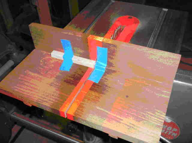

In review of this chapter, I realized that the table-saw has some assets that the bandsaw can't duplicate, for making exactly parallel smooth faces on workpieces. One of my favorite dress-ups for wood pens is to use a small slice of drilled Corian as the middle decorative band (replacing the narrow gold ring normally included in the kit). I made a special sled for doing these delicate cuts with a better safety factor..... This photo got messed-up in my several clips/pastes, and now it looks like it's grainy enough for the other PTWFE shots!
