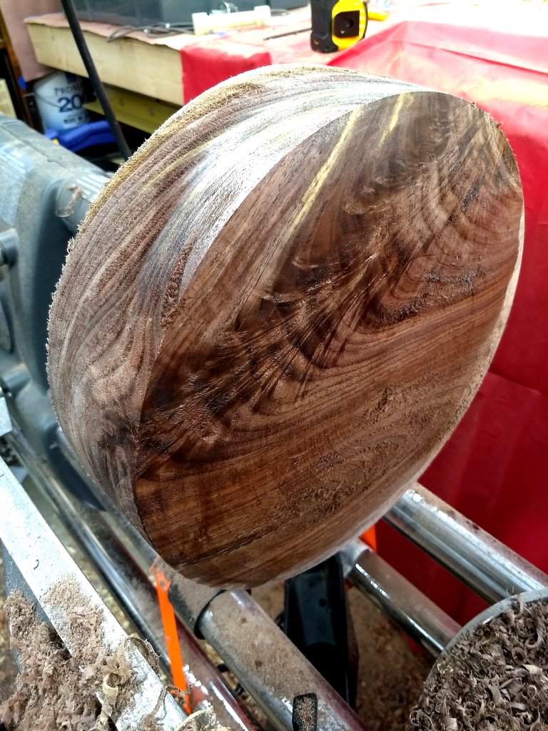

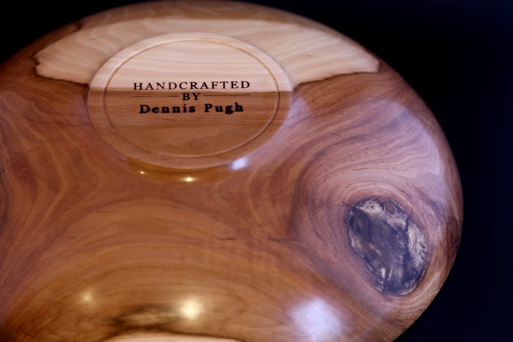

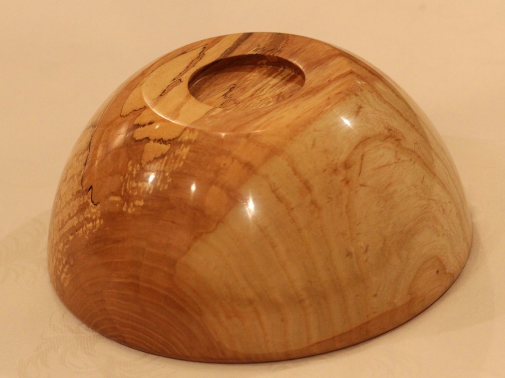

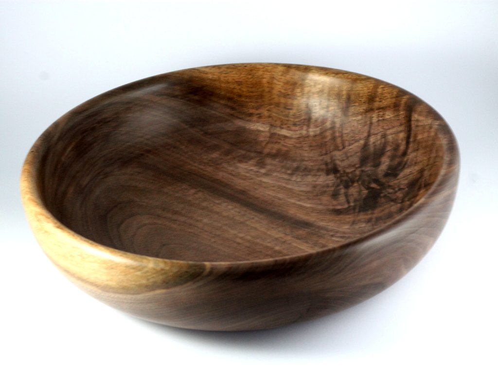

Posts: 3812
Re: Which older Shopsmith as a lathe?
I've turned several large bowls on my Mark V, and these require a speed reducer. With which you can do beautiful work. But you still have to take very light cuts, or else the whole machine will start resonating.

Rex,
As you can see Dennis has done some beautiful work with his Mark V, but as pointed out it is slow and a mass that size does create challenges for operating in lathe mode on Shopsmith equipment. Not that it can't be done, but these are special projects, i.e. low quantity typically and they take time. The size you gave for column repair should be doable and likely much more controllable than the large bowls that Dennis did, but still need care while turning. The balusters will be easier for sure than bowl turning, but the challenge is in replicating one design. If we could though, maybe it is best to take a step back and analyze the project to see what parts you want/need to do? If you want to take all of it on to learn and grow as a woodworker that is great. :) Sometimes woodworking projects rather fill a need and it is more of the "let's get this done" category. IF it is the latter, I have some advice to share that may help. My woodworking journey started as a teenager. In college I got married and built a China cabinet and dining table for my wife in my Dad's shop. The China cabinet is beautiful and I did all of it myself including raised panel doors, but I wasn't into woodturning then so I bought the table legs from a catalog (limited internet back then). I built the rest of the table using those purchased legs. Similarly, I am not a chair maker and honestly have no desire to build wooden chairs, so I bought chairs from an unfinished furniture store. I stained everything to match and we still use this as our dining set today many decades later. My point with all of this is perhaps you should pick & choose what parts of the project to outsource and what parts to take on yourself. I am still guessing here, but let's say you have a few porch column sections to repair, then perhaps get a Shopsmith or other lathe to take on those parts and give it a go. This will fill both the need and the want. IF there are LOTS of balusters to do it may be best to just purchase them. There are lots of online places that fill batch orders like this. You just have to figure out which one has a design you want and order them. Some even do custom designs for you. Another option is do they have to be round? I made a baby crib and the balusters were a slatted type, flat on front and back and cut/curved on sides. Point being that these are easy to batch out with a jig on a router table after bandsawing them. Easier to take on than hand turning lots of balusters. I don't know what the balusters are for, e.g. stair railing or porch railing, etc., but I believe the quantity of these need to be considered for your project. I have been woodturning off and on for a few years now doing bowls and salt/pepper mills. I could replicate and make a duplicate of one design if I chose to, but honestly I would be very slow at it having to compare against the template with calipers. It is very slow for a newbie like myself to start/stop the lathe over and over to check and re-check a design to match it for likeness. I know because my first salt/pepper mills woodturnings were a copy of my gourmet Peugeot ones from my kitchen that are intricate in design.
