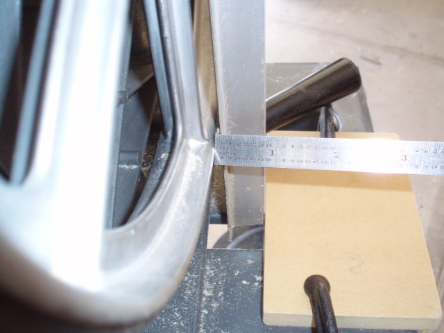

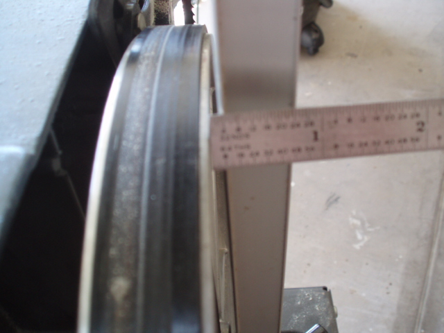

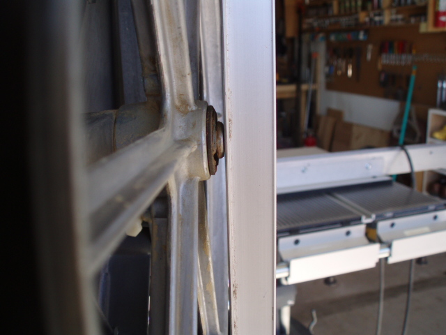

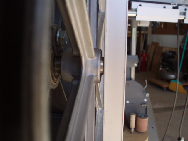

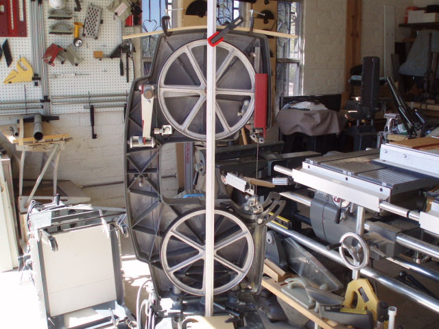

JPG et al, Actually, before you draw any final conclusions from the content of this thread - you ought to pull the table off your band saw and do a thorough vision inspection of wheel and axle alignment. You might be surprised at what you learn.
[ATTACH]3688[/ATTACH]
How I located the straightedge (axle to axle)
[ATTACH]3689[/ATTACH]
Upper axle
[ATTACH]3690[/ATTACH]
Lower axle
[ATTACH]3691[/ATTACH]
3/16" gap
[ATTACH]3692[/ATTACH]
3/16" gap
The really interesting part occurs when you place a straight edge first on the upper wheel and then on the lower wheel.
Try it, I think you will be surprised. I was.

I was surprised also. The upper axle extends 1/8" more proud above its rim than the lower axle.
Using Dusty's axle to axle reference(vertical straight edge), I measured the following:
Lower pulley lower rim 1/8" under straight edge.
Lower pulley upper rim 1/8" under straight edge.
Upper pulley lower rim 1/8" under straight edge.
Upper pulley upper rim 5/16" under straight edge.
This indicates that the top of the upper pulley leans AWAY from the straight edge.
Locating the straight edge against the LOWER pulley(vertically) results in measurements 1/8" less than those above.
Locating the straight edge against the upper pulley the upper rim of the lower pulley is 1/8" below the straight edge.
There is a SLIGHT play(about +/- 1/32" at rim) in the upper pulley(shaft and linkage), but this takes a set once the blade is tensioned. The measurements above were taken with tension set(to prevent the play from affecting the measurements). The 1/4" blade was riding on the back half of the tires(teeth about in the center of the tire)
I believe these measurements are consistent with my understanding of how it should be(top pulley tilted slightly out of the plane of the lower pulley causing the blade to drift slightly towards the frame so that the double bearing(guide) can control the tracking of the blade). This causes the BACK edge of ALL blades to track about 1/4" inside the center of the tire.
Corrections solicited and appreciated. TIA
