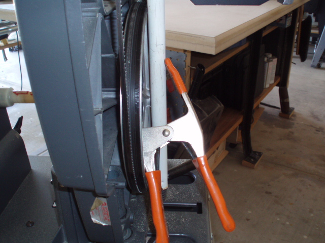

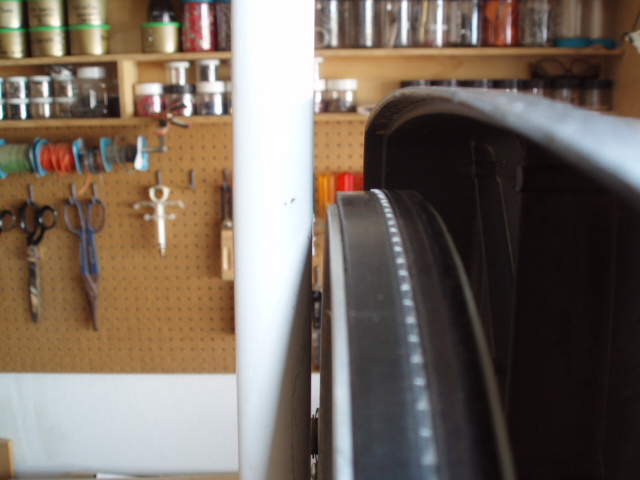

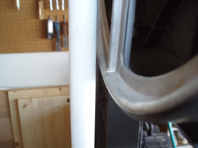

I took a couple pictures that are intended to show how the two wheels relate to one another (in terms of not being coplanar). The lower wheel does set forward of the the upper wheel but does not rub on anything.
I hope this help with your analysis.
[ATTACH]3676[/ATTACH]
Straight edge attached across lower wheel.
[ATTACH]3677[/ATTACH]
Offset about 1/4" forward of upper wheel (top).
[ATTACH]3678[/ATTACH]
Offset about 3/8" forward of upper wheel (lower)
dusty wrote:I agree with SDSSMITH, it does not sound like your lower wheel is properly installed.
I'm Confused! I thought it was supposed to lean the other direction(top toward 'frame').:confused:
I don't know about that. I just know that what you see is what I have. It seems to track properly - I think.
Do you have pictures that you could post to show what you believe is suppose to be?
Anyone else have an input. I have two bandsaws and they are both similar (in this regard). Maybe I have a problem and in my ignorance I don't even know.
dusty wrote:I don't know about that. I just know that what you see is what I have. It seems to track properly - I think.
Was the blade tension set, or was it 'loose' when these pic were taken?
JPG40504 wrote:Was the blade tension set, or was it 'loose' when these pic were taken?
The blade was tensioned. I had just finished re-sawing some pine molding.
