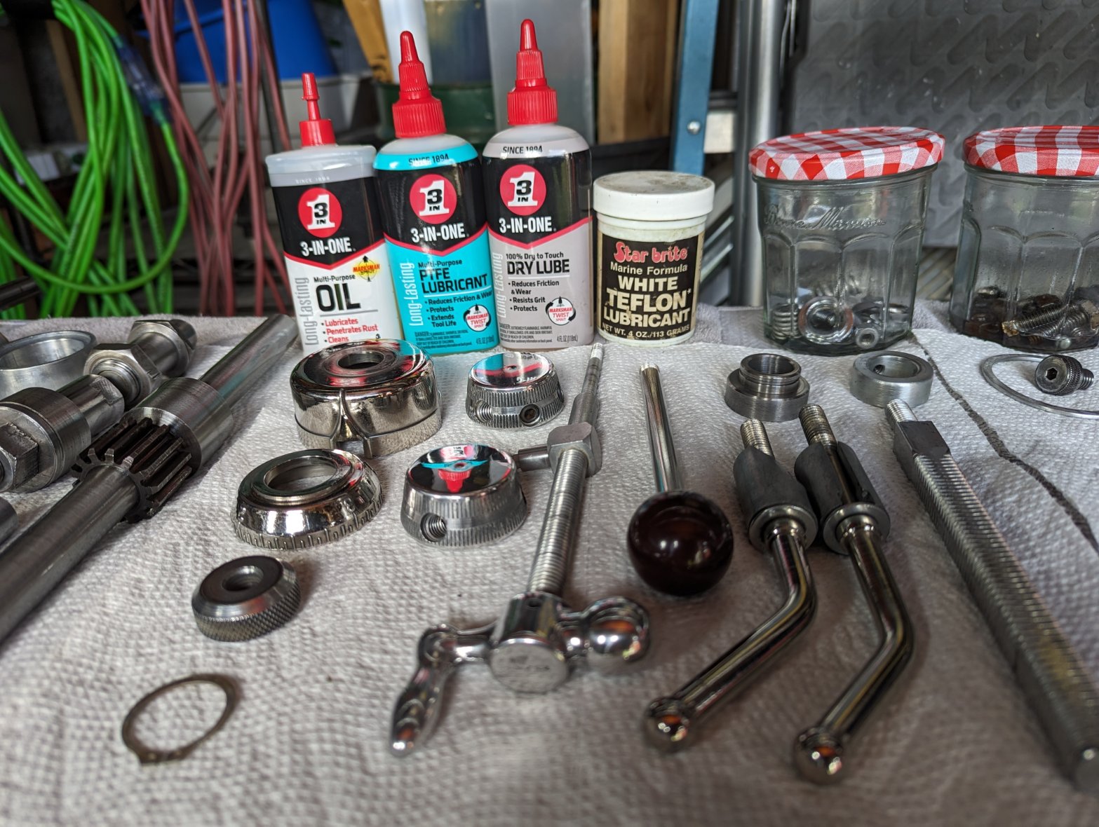

Question: For where light oil is recommended, I have been using the old 3-in-one oil and where light grease is called for, I have been using Lithium grease, do these seem like good choices for the 10ER or are there better options?
Also was thinking about using Dry lube on parts that are exposed to saw dust and was wondering if anyone has tried the dry lube on ways instead of wax and how that worked out?

3in1 good fit. Lithium grease, I use it.
FWIW 'polished' thingies tend to slip when grasped. Look pretty though!!!
I think the wax is tried and true for decades now. Dry lube on lock threads(quill/way).

Ooooh … those are SHINY!
Floor wax (JPW, Minwax) on the lightly loaded stuff like way tubes.
For quadrant gears and fence locks, powdered graphite has served me extremely well.
On the quill and quill-gear shaft, I’ve had a few sticking problems. My best solution to date is to to hit them first with dry graphite, then with some powdered Teflon spray, and then with a shot or two of WD-40. The WD-40 isn’t a particularly good lubricant itself, but it seems to does a good job of dispersing the graphite and Teflon deep into the mechanicals, and it mostly evaporates in short order. I stay away from anything that will bind to sawdust.

Thanks for the feedback, was concerned that I was not using the correct or optimal lubricants.

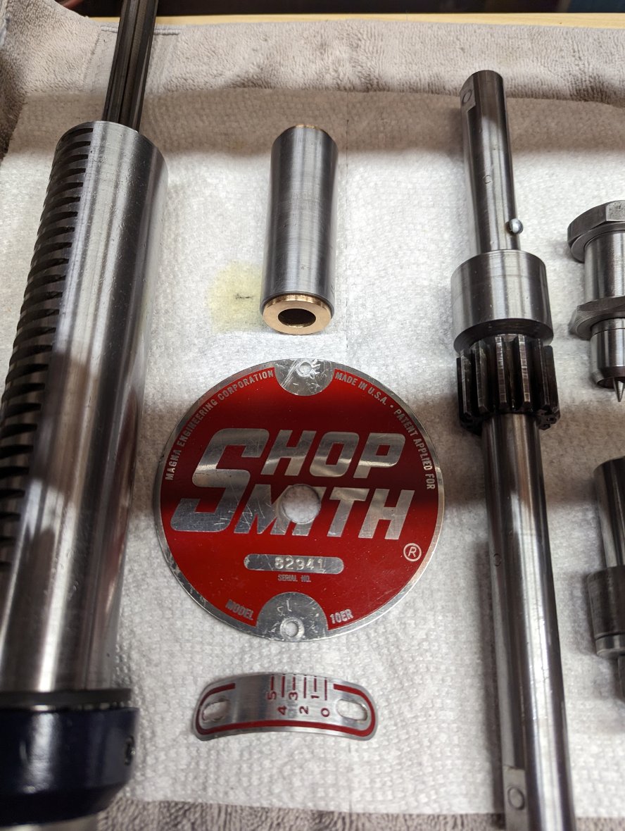

This is a trivial question but it's bugging me as to why there is a hole in my SS cover plate, I thought it was supposed to be there for access/peep hole till noticing pics of other 10ER's don't have it. I knew the original owner and he would have had a good reason to put it there, any thoughts or guesses?
I don't believe is seances or Ouija boards to ask the Colonel why he did it so relying on the board.
- PXL_20231007_010528774.jpg (200.85 KiB) Viewed 3092 times

The recommendations you have already received are good ones for lubricants. 3 in 1 oil is a good choice for the Floating Pulley and Bearings on a Speed Changer. I use White Lithium Grease on the Pinion Gear and Quill teeth. Easy to "clean up" if it collects sawdust and redo. As for a light coating of oil on bare metal parts as instructed in the Owner's Guide DON'T. Use the following addendum to supplant your original Owner's Guide recommendation.

Re: New Shopsmith Owner
Hole in cover plate is for a power switch?
Great idea, maybe he added an accessory switch for say a lamp or vacuum system at some point.
