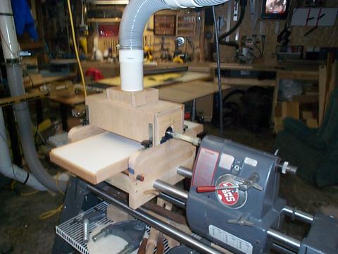

Is this what your taking about? I found this over in the Shopsmith forum on Yahoo.
There are 3 picture in the photo section titled fscott13850.
No planes that I could easily find.
[ATTACH]109[/ATTACH]

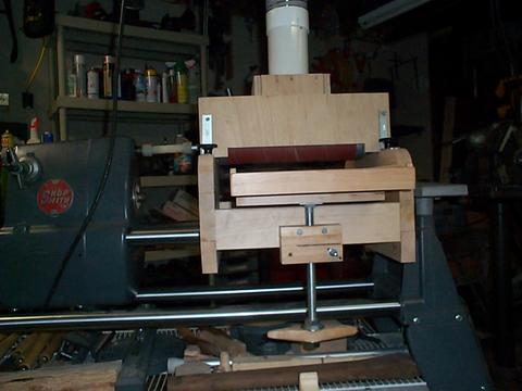

This shot may explain how it works
[ATTACH]110[/ATTACH]
Good work Ed,
Yes that is one I remember seeing before. I remember a couple of other designs as well... maybe they are somewhere else.

Sorry to be jumping back into this discussion late, but I didn't have a chance to get into the shop until this morning. When I did, I took a look at the table/carriage on my MkV 500 and found that, sure enough, the stop collar prevents the table from dropping low enough to accomodate the disk sander if the stop collar is installed per instructions. The stop collar is a much more recent addition to my SS than the lathe-mounted sanding drum, so that was not issue back when I was using the drum. No problem though if the stop collar is put on below the carriage. That is a GREAT idea!
