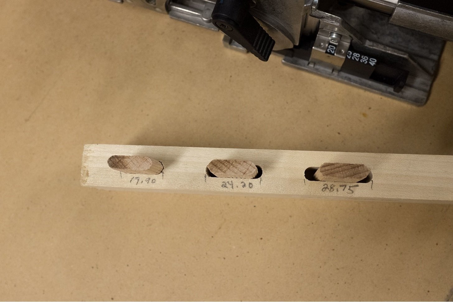

RFGuy wrote: Fri Oct 13, 2023 8:56 am When I mention vertical alignment I am referring to two boards side-by-side, edge glued where you want the top to be perfectly flush. So, the desire is to have vertical alignment between the two boards such that the top surface is the reference to achieve a flush surface. Note that biscuit joinery gives you this with vertical alignment, but they don't give you any horizontal alignment, so the board ends could be askew relative to each other. For panels you don't have to have horizontal alignment from the joinery, but must make sure you achieve this on glue-up or you will need to trim both ends of the panel instead of simply sanding them. Dowel joinery isn't very forgiving because they provide both vertical and horizontal alignment - in other words their placement needs to be precise. Consequently any error in placement will either result in a panel that won't assemble or result in a top surface that isn't flush. Loose tenon joinery, such as the Domino, can give both vertical and horizontal alignment. On a large panel like a table top, you can mortise the first mortise on one end of the board with the tight setting. Then the rest of the mortises down that board can be done on one of the 2 optional loose settings that they offer. This results in a mortise that has more side to side play but keeps the same mortise height in the vertical dimension. As a result, the one Domino on the panel ends (one in each board to board connection) sets the horizontal reference so that all of the boards will be flush on the end, while the interior dominoes will maintain the vertical alignment only. This makes panel assembly easy and quick which is helpful considering the glue sets quickly during assembly of a panel. Without this feature, making all of the domino mortises tight fitting would have the same problem as dowel joinery and require absolute precision of every mortise or the panel would not assemble, i.e. holes in the wrong places. :o
P.S. I know a picture would really help with this, so below is a pic illustrating the 3 different width settings of the Festool Domino. The one on the left is the standard (tight setting) and what I would use on one end of a panel. Then subsequent mortises down the length of the board would be done on the 2nd setting (loose setting). In such a way, the 1st (tight) Domino sets the vertical and horizontal alignment between the two boards and each subsequent loose Domino down the length of the board holds that vertical alignment to give a flush top surface to the panel. This gives some small horizontal play of each loose Domino so that a panel can be easily assembled at glue up. Unfortunately you can't do something similar with dowel joinery. Biscuits give a little bit of horizontal slop and make assembly of panels easier, though not all biscuit machines are equal in quality...
JMO,
Thank you for breaking this down for me. It was really enlightening and it truly helped me grasp everything you were conveying. It all makes perfect sense, I get it. Probably not going to buy a domino, but now I understand what makes them so sexy. ;)
