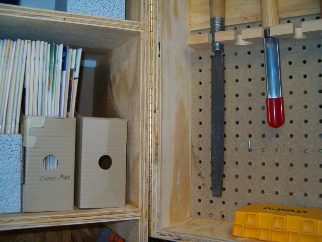

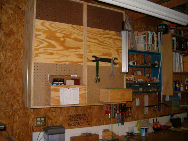

JPG40504 wrote:If using 1/4" plywood for a back, I do not understand what is supporting the 'ledger' on the cabinets. IMHO it is no better than nothing and might as well be omitted. This requires attaching the 'cabinet ledger' board to the back edge of the sides.
I have used 1/4" plywood backs on both of my large wall cabinets. The cabinet beveled interlocking ledger is glued and screwed to the plywood back. The top of that ledger butts up against the top of the cabinet.
After the cabinet is hung, most of the force bearing on the two ledgers is vertical. Yes there is a small amount of force that is trying to pry the ledger off of the plywood back, but certainly not enough to worry about and certainly not enough to shear or break a 1/4" plywood sheet.
The most important function of the cabinet back is to keep the cabinet square. = Prevent racking.
Here is a couple photos one shows the lower right corner of my library cabinet. The other shows the outside of the closed cabinet. The cabinet is approximately 4ft by 4ft by 12" deep. It is holding approximately 200 woodworking magazines. Wt? - don't know, but it is heavy. This cabinet also has doors that serve as a tool cabinet. All of this hung by a ledger on a 1/4" plywood back.
