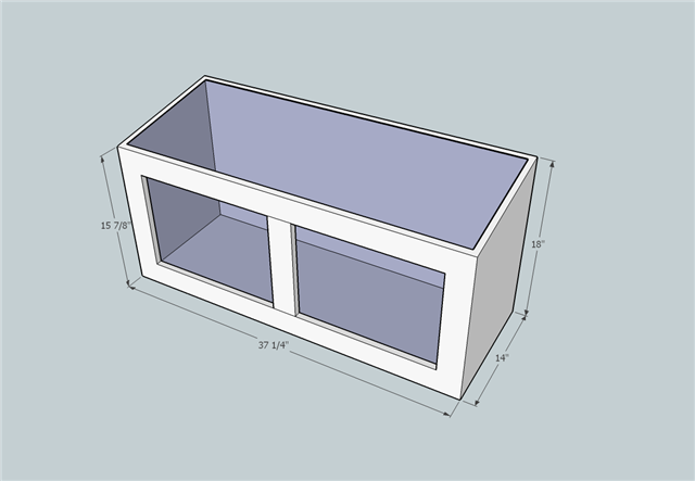

I am preparing to build wall cabinets for in my shop. The cabinets will be across one end of the shop which is 228" wall to wall.
I am thinking that the back and sides will be 1/2" plywood while the bottom is 3/4". The face frame will be 5/8" pine.
Exposed surfaces will be painted.
I am seeking advise. All comments are welcome but what has really stopped me is dimensioning the face frame and determining the type of joint to use for the corners formed by the back and sides.
Remember, these go in the shop and the cabinets will be used to store an accumulation of items that could get heavy. They will be screwed to the wall and will fit flush against the ceiling in the shop. The ceiling has a slight slope; 2 1/8 " in 14" which explains why the back vertical height is different than the front.
Filler strips (approximately 2.25") will be used on both ends to fit the cabinets into the existing (228") space. I chose to do this rather than to try to make the cabinets fill exactly. By doing this, the 6 cabinets can all be dimensioned the same thus permitting mass cuttings.
I have done a rudimentary sketch of the carcass showing "outside dimensions to help me communicate my thoughts.
I often do not go into this level of pre-planning. I sorta get basic size in mind and start cutting. Each piece being cut to fit with all others that have already been cut. This is known as "real time custom cabinet making" - where every piece is custom cut to fit where it is needed.
This is an attempt to approach it correctly.
[ATTACH]4552[/ATTACH]

Off the cuff suggestion(s):
1) rear to side joint - simple rabbit joint with front edge of back longer than wall side.(GLUE)
2) top of bottom flush with top of facing. Cleat sides to support bottom(back and sides and front).
3) cleat top edge of back(inside) to provide extra support for attaching to wall. Use bottom support cleat likewise.
Nothing fancy, just support where I think it is needed. The flush bottom prevents things hanging on the facing.
If desired, furring strips(horizontal top & bottom) with rabbited edges(or beveled) could be used to help 'hang them(strips on both wall and back)'. This would leave a small gap at the ceiling. That could be covered up with the same method as covering up the ends(trim). This would also allow removal if needed in the future(after removal of 'trim').
face frame joined to cabinet
Dusty, I have had success joining the prebuilt face frame to the cabinet box by using glue and biscuits. No stress on the face frame from the weight in the cabinet. As far a joining the sides to the back and bottom, i would use glue and screws along with biscuits. That should be plenty strong.
What would concern me is only using 1/2" ply anywhere on the cabinet especially the back if your concerned about weight and/or strength . I would use 3/4" ply all around and a 1 x 4 cleat attached to the back and sides as a nailing (or screws) cleat.
Be sure to share some pictures when you get them complete.
Good luck.

Opps, you said dimensioning the face frame
Sorry, I answered your question thinking "attaching" the face frame.
I would think an 1 1/2" face frame with a 2 or 2 1/2" vertical center piece would look good and provide an adequate opening to retrieve stuff.
San Diego
San Diego
