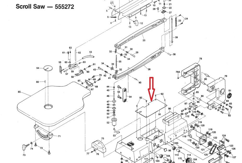

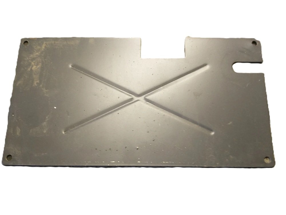

I don't know if you noticed it in my last post but the part in picture 5 looks like the Base Plate, as shown below, for the Gray Shopsmith Scroll Saw.
_
514992-01 Base Plate b.jpg (46.78 KiB) Viewed 25983 times
It's location is shown in the drawing below. It attaches to the middle of the Base.
_
Base Plate arrow.jpg (106.3 KiB) Viewed 25983 times
Crimekilla
Silver Member
Posts: 11
Joined: Mon Apr 28, 2025 2:20 pm
Re: help with my new-to-me shopsmith.
Post by Crimekilla »
LOL, id say it seems weird to have just that part of the scroll saw, but after all I've read about these things, having only parts is a norm. some guy out there is scouring the internet looking to replace the missing baseplate to his scroll saw, while im out scavenging for the missing table to my strip sander.
Posts: 4538
I'm guessing that if you are missing the Table for your Strip Sander you are likely missing the Trunnion and screws too. Hopefully you have the Locking Knob and washers still. The Table parts are available new from Shopsmith and are currently 15% off regular price. If you're not in a hurry, you could try to find them used. I haven't seen that many parts for the Strip Sander for sale used but they do come up from time to time.
As for the Scroll Saw Base Plate you could put it up for sale locally and it may get to the one it came off of. If you're lucky that person may have your Strip Sander Table and you could trade. Maybe wishful thinking but you never know, it could happen. :)
