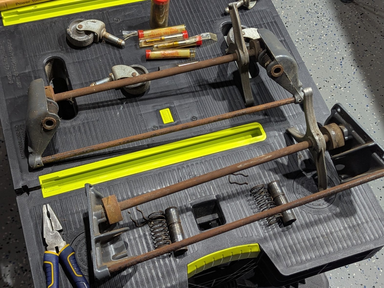

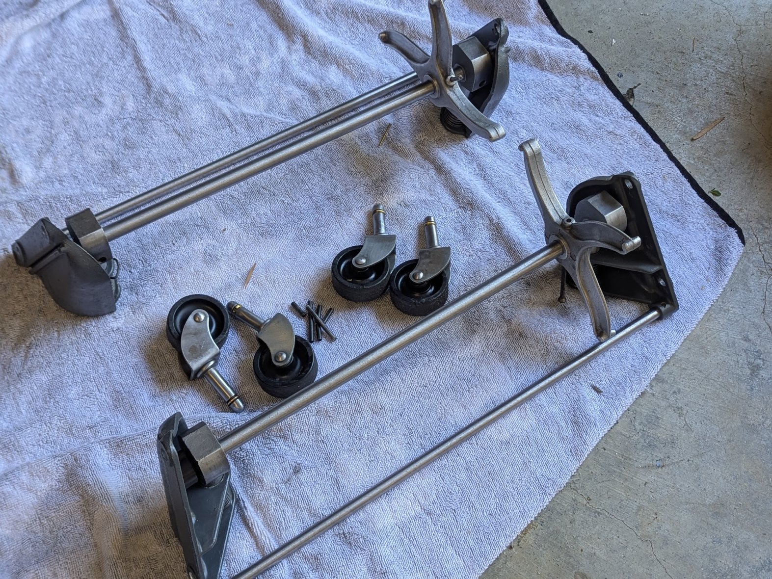

Here are my casters that arrived from the US a few days ago, before and after a big clean.
I posted this on Facebook Owners Group and was told a real final finish would need me to blue all the shafts. I think I might keep it shiny and apply penetrol. I already used it on the tubes inside and out, but after reading a few forum threads on it yesterday, it seems like it might keep rust of these for a long time, and I like the look, matches the tubes!

BLO(Black Oxide) Is a recent innovation not age correct for your M5. IMHO paste wax is sufficient if restored timely.
Kudos for reassembling them correctly(lotsa wrong ways) - not sure the top one is?

Oh haha, mate it took me a good hour of fiddling to understand how it works, I only found your tutorial after I'd already sorted it. I THINK they're both good now but I haven't put the roll pins back in - I'm ordering a set of imperial roll pin punches so I don't mushroom them anymore then I have, and will need to file them down a bit.
Top one should be good, the pedal is a little different but same orientation.

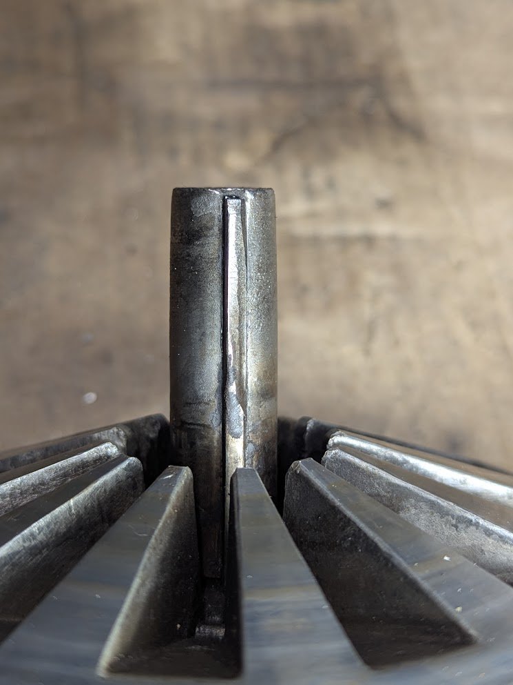

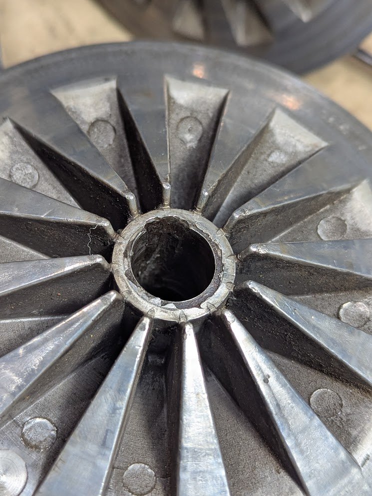

Well damn - we have some serious issues! Checkout the control sheave keyway - totally wrecked and unusable. The Idler key is also nearly shaven flat.
The motor sheaves/key look better, but there is also some play/slop in them, so I've just ordered an assembly on ebay with a full set of new items, hopefully that fixes it.
No eBay listings for Idler Assembly. I might buy from Shopsmith if nothing shows up.
I had really hoped I'd have less problems, but I'm pretty sure this wasn't properly tuned in 43 years, so it makes sense. Hopefully the motor is fine, and then she'll run like a dream.

The idler key and motor shaft key stock is standard hardware(here in US) 1/8" square keystock, but the idler shaft key has one end bent slightly to drop into a recess in the idler shaft so the control sheave covers that end and thus secures the key.
Replacement of control sheave is a no-brainer fer sure.
It is the orientation of the foot pedal to the cams that I thought may be incorrect(top one in your pix).
Re: Ever seen a genuine Australian 230V/50Hz Mark V before?
You were totally right. The top foot pedal needed to be rotated 180° and now they're perfect.
