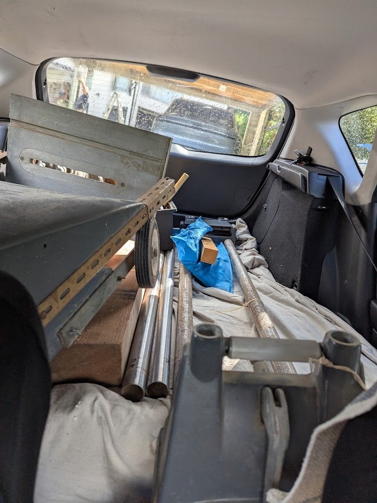

First time, first day owner in fact! Can't believe I found it 30min away! They are incredibly rare in Australia, only a handful of confirmed owners on the forum far as I can tell. I just happened to see a Workshop Companion video a few days ago and it reminded me to check Marketplace. Thera are no others listed in Australia.

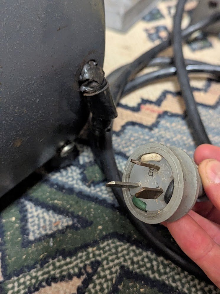

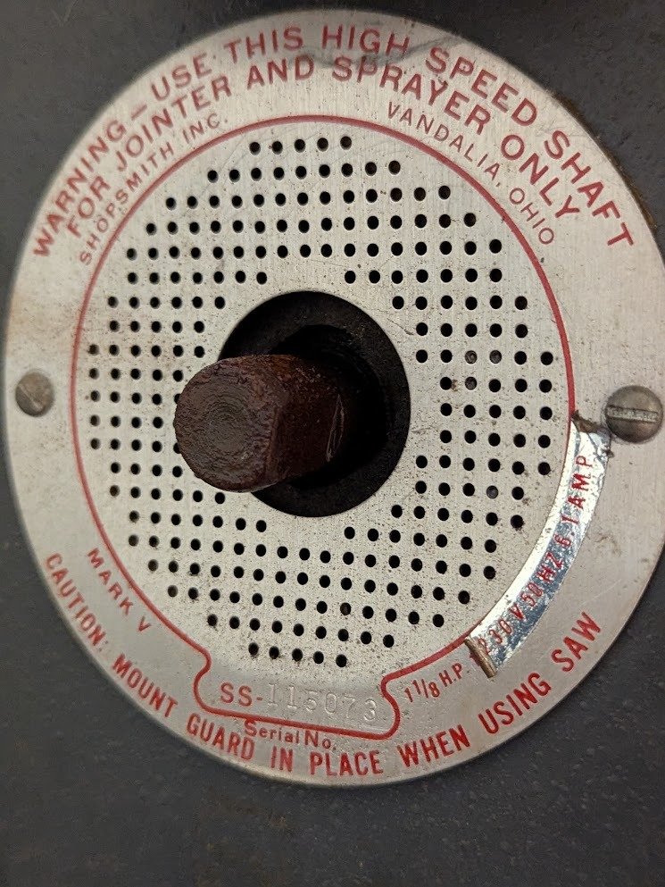

Serial number SS-115073, 1-1/8 HP. There's a sticker carefully applied over the original specs on the nameplate showing 230V/50Hz/6.5 amp. Looks like ShopSmith did it, has anyone seen this before? I haven't opened the headstock yet so I don't know what the motor story is. There's some electrical wire wrapped around the base so I'm curious what I'll find. Tips welcome.
Best I can piece together on history: a farmer in regional Victoria who occasionally imported machinery acquired it in the 90s, passed down to his grandson, who I picked it up from. Serial number puts the machine in the early 1980s I believe. I wonder how it crossed the Pacific?
It's in decent shape, but no castors, no drill chuck, missing lathe centres, bit rusty. But it runs! Running on 50Hz means everything is about 17% slower than the speed chart.
700 × 50/60 = 583 RPM, 5200 × 50/60 = 4,333 RPM

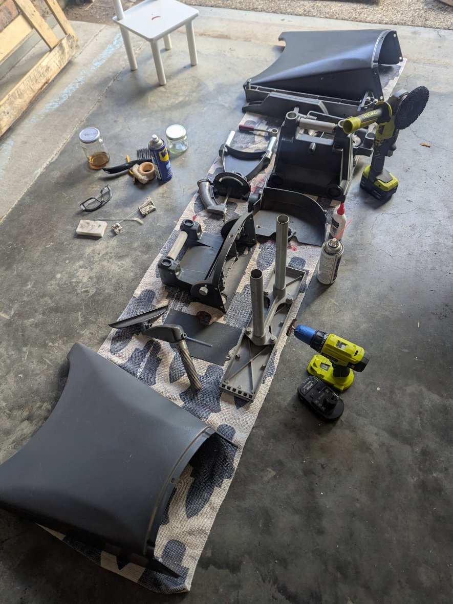

Currently soaking lots of stuff in Evaporust and following advice from My Growth Rings.

Serial Number SS 115073 was made in July 1983. Shopsmith has and still actually does with the Mark 7 offer a 220 Volt version but the 50Hz is unique. Over time, there has been a lot of Shopsmiths exported to other countries. Australia first had the Shopsmith Model 10ER (aka10E shown on the nameplate) being made there back in the early 1950's before the Mark 5 was introduced.

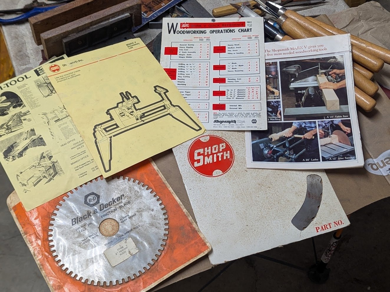

I noticed in one of your pictures you did get some documentation. Hopefully that included an Owner's Manual and parts diagram with the parts list. Since your Mark V is the 500 model you can use the 500 model drawings and parts list from here on the Shopsmith website under Shop then Parts. There is a number of supplemental information sheets available for free download as a PDF under Learn then Manuals & Information. Unfortunately, the most recent Mark V 500 manual is not available as a PDF for free downloading but there are other older manuals available out there. I can guide you if needed. The MARK V 520S Owner’s Manual (For 557501, 557500) is available for Download as a PDF. Although it has the 520 Table/Fence System and Double Tilt feature the Headstock is the same. It could be a helpful reference for you if needed.
Hopefully it has a 5/8" Arbor with it so you can buy Saw Blades for it locally to use. That could be either 555321 or the 505506 5/8" Universal Arbor both shown in the picture below. 555321 is specifically for Saw Blades while 505506 can be used for other accessories like a Dado Blade set.

Arbors - It came with 3 arbors (no drill chuck), but I haven't measured or verifed what they are yet, they were all very rusty and seized, so treated in evaporust.
Manual - I didn't get one, only what you see pictured, but I read halfway through the free PDF Summary Manual on the plane yesterday, will finish the rest last this week.
Headstock - I breifly opened it (after finally I releasing a very siezed bit on the rear spindle) - and it was packed with dust,the stamped steel casting is rusting internally, so I closed i back up and will deal with all that when I'm back. If I had to guess it's never been properly maintaned, probably all original parts.
I think I need to do a full headstock teardown, then see what I need to buy - bearings, pullies, etc. The issue is shipping on each individual item is 1-2x the cost of the individual item on eBay. I hope to find someone I can ship parts to and do one big order to Australia, Spike from Sparkle Guitars already said he might be able to help on Facebook which is awesome.
I'm very new to ShopSmith, I only learned what it was literally a week ago (6 days in fact), so "I don't know what I don't know", but I'm learning. The moment I realized this tool existed I knew it was for me. Now I'm just trying to learn as much as I can to make it economical to restiore and use.
