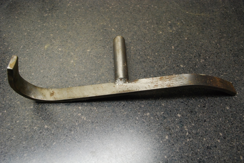

Lathe tailstock, tool rest (w/ extra, curved tool rest - pic attached), assorted dead centers

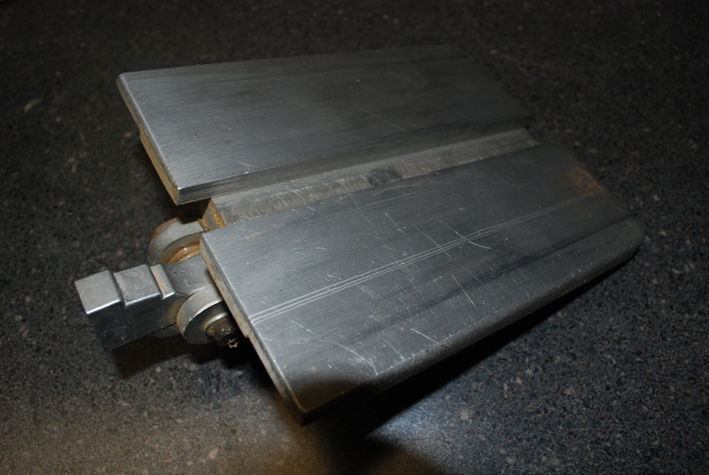

and 1 small table with a miter slot that I cannot identify. pic attached.

- small table.JPG (265.78 KiB) Viewed 11203 times
- curved tool rest.JPG (298.57 KiB) Viewed 11201 times
Extension tablle?? Or are you calling it an outfeed table???
It is an INFEED table. Formally called (or named) " MARK V 500 Front Table Extension" http://www.shopsmith.com/ownersite/item ... =Find+ItemJPG40504 wrote:Extension tablle?? Or are you calling it an outfeed table???
555306 is for outfeed support on a 500.

Thanks for the help on that extension table. It looks like it gives you more room for using the miter gauge on wider pieces. That is something I could use on my 10" Craftsman band saw, which I guess I will be using for longer than I hoped... I placed my parts order over the weekend and called for parts availability today. The speed control assy and control sheave assy are both on backorder
