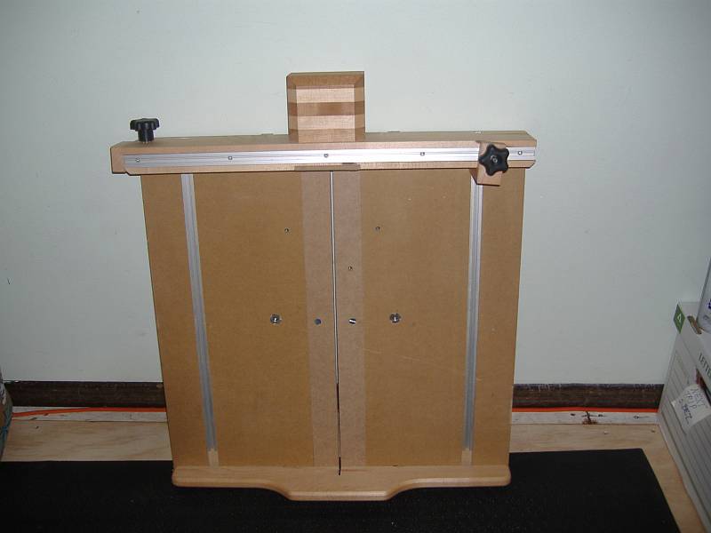

How much does the Appalachian weight, Ed?
PS 10/20/09 - First liar never has a chance but here it is anyway: My modified cross cut table weighs 14.2 lbs.
Well I got a few confused looks from the wife but the bathroom scale says 12 pounds. I personally think the scale says things weigh more then they do... at least when it weighs me. I also wonder why wife's give you strange looks when you bring woodworking fixtures into the kitchen or bathroom... bedroom????
The other thing about the appalachian sled is it is also more balanced due to the dual runners cut down the center design and also front to back.
I'll put a picture below so it might be easier to see what I was trying to say.

reible wrote:Well I got a few confused looks from the wife but the bathroom scale says 12 pounds. I personally think the scale says things weigh more then they do... at least when it weighs me. I also wonder why wife's give you strange looks when you bring woodworking fixtures into the kitchen or bathroom... bedroom????
[ATTACH]6244[/ATTACH]
Thank you, ED. Two pounds lighter and it appears to be considerably larger than the Shopsmith version. This increased front to back work area is very important.

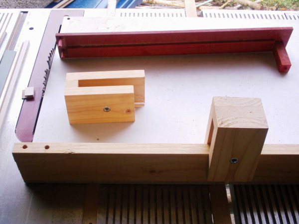

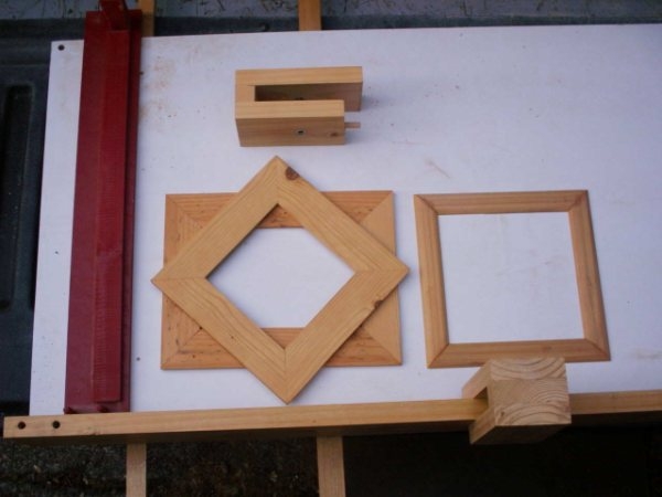

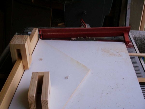

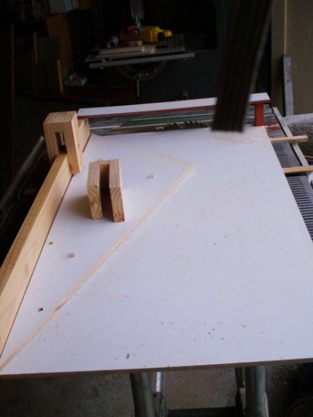

Have a SS Sliding Crosscut Table but ....
I made several crosscut tables because the commercial table has to be adjusted, a fence added for measuring tape and stop blocks.
1. I added a guard to mine to prevent casual contact with the saw blade. The guard is removable and held in place with dowels in the guard and in the pedastal (leading edge).
2. I made stop blocks that are tightened over the fence with socket button head bolts and burrs embedded in the block. I use the 5/32 hex wrench to tighten the stop block.
3. I made triangles with 45 - 22.5 and 30 - 60, angles for mitering stock.
4. The triangles have silicon caulk buttons on them to raise them above the table and keep the edge above the sawdust on the table.
5. Test frames were made to proof the triangles - crosscut sled.
I would suggest making the guard longer to cover the blade when it exits behind the fence. Consider making the guard from polycarbonate (clear). Build an offcut table if you are going to use the offcuts (or better yet a ZCI offcut table as shown in the opening post. How is it held on the table?).
The cross cut table was invaluable for cutting laminate flooring. The cross cut sled was used to cut panels for intermixing two colors of flooring laminate.
I lost a utility knife and had to hunt down the measuring tape 47 times during the 5 day project replacing water damaged flooring in hall, Dining room and kitchen. REPLACE THOSE POLYETHYLENE ICE MAKER water lines!
Custom Crosscut Table with Guard, Triangle, and stop blocks. Table is made with 1/4" vinyl covered MDF. Vinyl was peeled off the edge of the MDF and glued to MDF. Fence is a jointed to make it straight and smooth. The edge of the table is used to support the stock as a zero clearance (table). Triangle with silicone calk buttons for cutting miters. Trianges have holes along the base to allow them to be clamped to table with the dowels protuding from the bottom of the short leg of the asymmetric stop blocks. [Please excuse the cammera strap in the upper rght. [ATTACH]6250[/ATTACH]
Crosscut table with Guard removed. Triangle. Asymmetric stop blocks.[ATTACH]6247[/ATTACH] [ATTACH]6248[/ATTACH]
Test miters with the 45 degree miter on the triangle, dual guides, bottom of the guard showing dowels in guard and the dowel in the pedastal. [ATTACH]6249[/ATTACH]
3. Two guides were used one in miter slot the other along the table edge.
4. I made triangles with 45 - 22.5 and 30 - 60, angles for mitering stock.
5. The triangles have silicon caulk buttons on them to raise them above the table and keep the edge above the sawdust on the table.
6. Test frames were made to proof the triangles - crosscut sled.
Custom Cross cut table with Guard and stop blocks. Table is made with 1/4" vinyl covered MDF. Vinyl was peeled off the edge of the MDF and glued to MDF. Fence is a jointed to make it straight and smooth. The edge of the table is used to support the stock as a zero clearance (table). Triangle with silicone calk buttons for cutting miters. Trianges have holes along the base to allow them to be clamped to table with the dowels protuding from the bottom of the short leg of the asymmetric stop blocks. [Please excuse the cammera strap in the upper rght. [ATTACH]6250[/ATTACH]
Crosscut table with Guard removed. Asymmetric stop blocks.[ATTACH]6247[/ATTACH] [ATTACH]6248[/ATTACH]
Test miters with the 45 degree miter on the triangle, bottom of the guard showing dowels in guard and the dowel in the pedastal. [ATTACH]6249[/ATTACH]

Crosscut Sled
allsas,
If that is the Shopsmith Crosscut Sled (555502) in your photos, did you relocate the miter bar so that the left side of the table was against the blade.
I really like the modification to the fence and the stop blocks look to be clever solutions.
? on Custom (homemade) crosscut sled w/Guard
The SS Crosscut sled is unsused. This sled was made with lighter materials than SS cross cut sled, 1/4" MDF instead of 3/8" panel, 1 x 3 x 36" pine for fence, therefore the concern about how it would perform. I wanted a lighter, smaller, sled than the ones that straddled the blade and an open leading edge for slightly wider materials. Lots of internet sources for making crosscut sleds.dusty wrote:allsas,
Cost for the materials was less than $5. Really makes cross cuts and miter cuts easy and accurate for the woodworking experienced challenged. Excellent starter project with terrific rewards before you fill your house with woodworking projects.
Using the extension table to rest part of the sled on and the 3 ' length make it usable for long pieces. It is useful for long pieces and for dadoing. The guard, is only a reminder to be careful, but it really reduces the discomfort of working around an exposed, whirling saw blade without becoming complacent.
Two guides were used, miter slot and table edge. Miter slot guide was doweled and glued to the sled with 1/8" dowels. The table is moved to the left side of the throat plate so that I can cut (wear) a little of the sled away and still get the blade close to the sled. The sled and fence show a 1/32" kerf from the inaugural cut.
The Guard is a compromise, it would be nice to have it wider and move the dowels away from the edge. A wider opaque gard is harder to place the material on the cut line beneath the guard. It is easy to allign the material with the edge of the sled and fence by sighting under the guard on the left side of the sled. That portion of the problem goes away when you mark the length on the fence or triangle leg, the second cut has the end/mirered cut on the mark and the material on the left side of the blade is the offcut.
With the triangles, I cut miteres w/o the miter guage and that allows a lot of support of the material, cutting long pieces, and worrying about the miter guage setup. Triangles were easy to make from measurements obtained from a drawing program.
The examples used the same mark on the triangle leg to make the three trial frames. Differences in the sizes is the differences in the widths of the frame stock.
