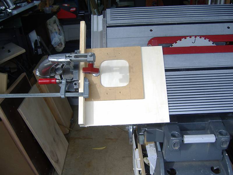

Perhaps a few picture might help, before we get to carried away on this project.
First, a picture of the 520 with the item I attempted to describe earlier. The sample piece is 8 x 8 inches and you have room to make the cut without any additional help. On the smaller 500 table you would need the front extension, if you don't already own one get one now.
[ATTACH]6541[/ATTACH]

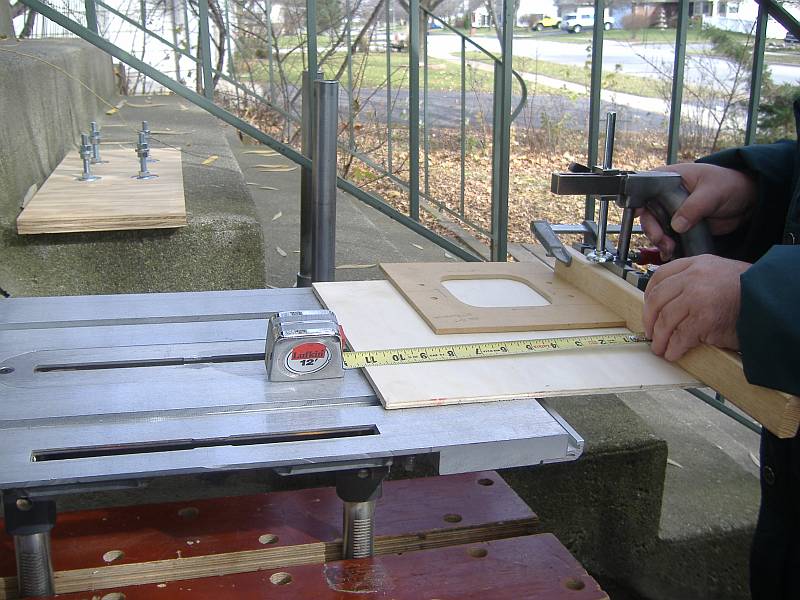

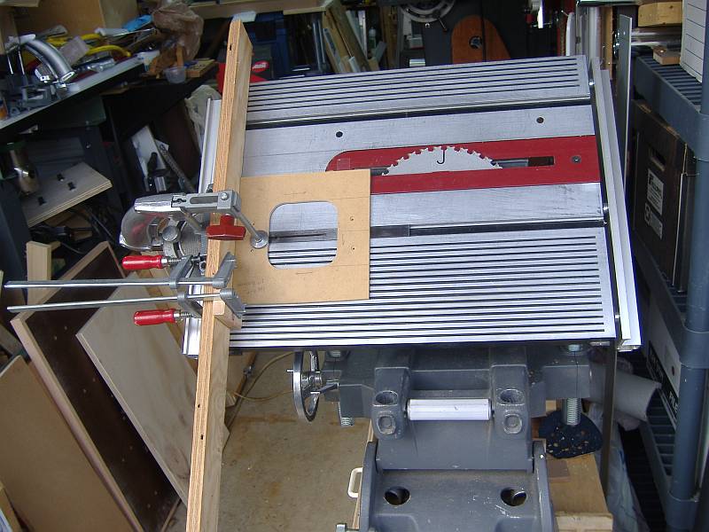

Since I started with the most simple way to do this I'll then show you a simple "sled" that will work without the front extension. I've posted this sort of sled before but you may have missed it. In this case I took a 12 x 12 inch square of 1/4" plywood, attached it to a board that would mount on the miter gauge. The plywood contacts the table and the board sits on the plywood. Make sure to use brass screws and to make sure they will not be in line with the cut. You have a few options when doing this, one shown on the 520 is with the sled cut off on one side to match the edge where the cut happens. Shown on the 500 would be the sled with the cut leaving support on both sides of the cut, this would be the preferred method.
[ATTACH]6542[/ATTACH]
[ATTACH]6543[/ATTACH]
In the picture if the tape measure is readable it will say 11-1/4" in front of the table insert opening. This is about the outside limit due to wiggle on the miter bar, at least on my table/miter bar combination. Yours might be better or worse but by the time you get to cutting something 8" long it should be fine.
