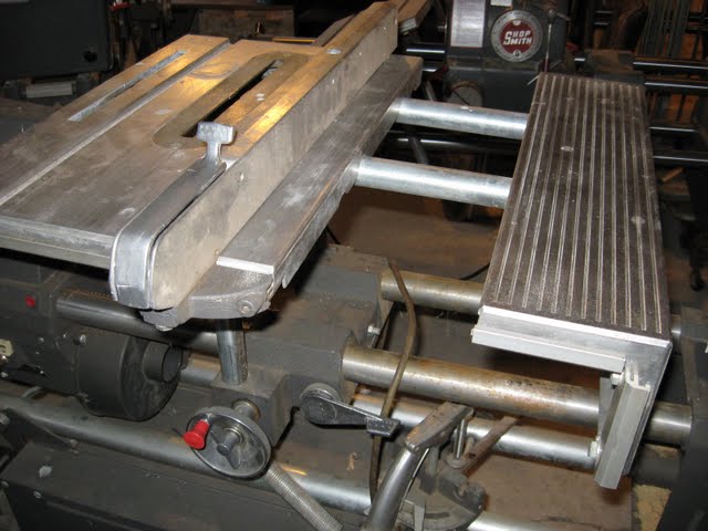

Not a problem I have but I have a couple thoughts.
What if you make a table surface out of plywood that extends past the edge of the table enough that you could clamp a wooden fence to the plywood?
Or...
How about a tall sacrificial fence attached to the regular fence and running the board flat on the fence instead of the table surface.
Just random thinking of other circumstances now...

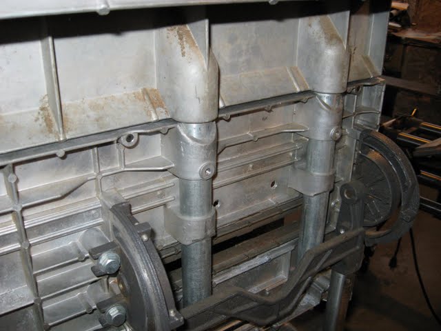

I have never tried that exact cut on a Mark VII but I think that the extension table would slide into the main table sockets far enough that the fence could be attached to the extension table rail. If the extension could not be inserted far enough without the tubes getting in the way of the blade then a wood spacer could be added to the fence face.
An extra Mark VII table extension with the tubes cut off a little might be handy to have around.
I still think an upgraded Mark VII with the new power pro motor would make a good 530.
Of course with a 510 / 520 you would just add an extension to the table.
I would make that cut on my TS-3650 so I don't know about my 510, if there is that much room to the right of the blade without an extension or not.
A couple of pics of the Mark VII table extension.
[ATTACH]6530[/ATTACH]
[ATTACH]6531[/ATTACH]
