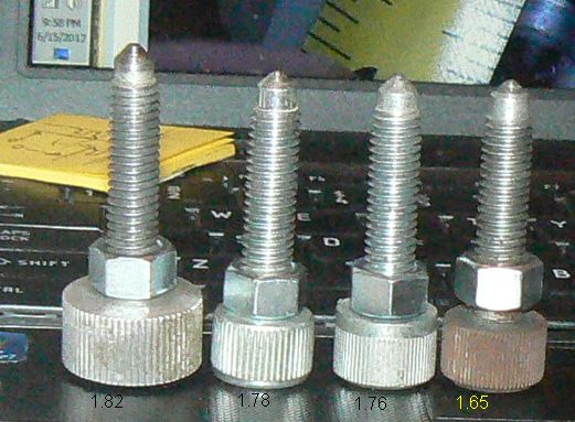

The distance from the end of the thread(at the head end) and the tapered end determines the 'range'.
4 different 'versions' - Mark 5 - Mark V - Mark V - Mid 80's 510
[ATTACH]17693[/ATTACH]
The figures are the approximate distance from the back of the nut at the thread limit and the tip of the tapered end. The one on the right is shorter than the others, and resembles tgamel's(short thread), but all work on all bases that they came out of.
[ATTACH]17694[/ATTACH]
Notice the third from the left(appears to have been fabricated from a screw).
Question is, what does tgamel's measure?.

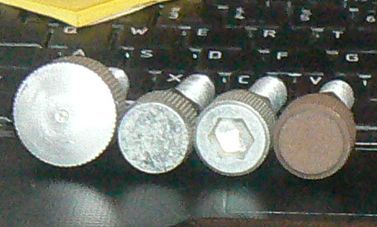

lock knob shafts.jpg (74.89 KiB) Viewed 20545 times
lock knob heads.jpg (46.11 KiB) Viewed 20548 times

By counting threads in tgamel's screw, it has 2-5 less threads(1/8-5/16") than the four screws shown above(and Ed's).
JPG40504 wrote:The head contributes nothing to the function at hand.
Check post #19 for the answer.

#19 States the total length of the screw. My question was length from the end of the threads to the tip. Sorry if I was not more specific with the question. My intended meaning was consistent with the rest of the post(#22)[the head don't 'count':D].
I believe it is shorter than all others pictured here.

I surveyed my "vast collection"(5) of knobs and found that they ranged from 1.9" to 1.75". Note that this is the fastener correct measurement.
The 1.75" was from a 2012 purchase new from shopsmith. If I get time later today I want to try that with my reference machine that I purchased new in 1976 and has the original knob. Results will be posted one way or the other.
Took a closer look at tgamel's screw and scaled it from the pix and I believe it is only about 1 3/8"(1.38) from the threads to the tip.
Results were that the shortest screw I have, 1.75" works in each of my three machines. In all cases the head of the fastener is about 1/4" away from touching the casting.
Reasoning would dictate that in my case I could use a fastener that is 1.50" or longer. Anything less then 1.5" would be questionable.
