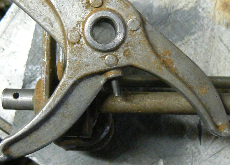

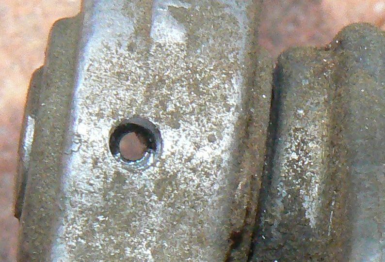

Drilling through SPRING PIN worked!!! Image
[ATTACH]8215[/ATTACH]
And after punching through 'new' hole!:)
[ATTACH]8216[/ATTACH]

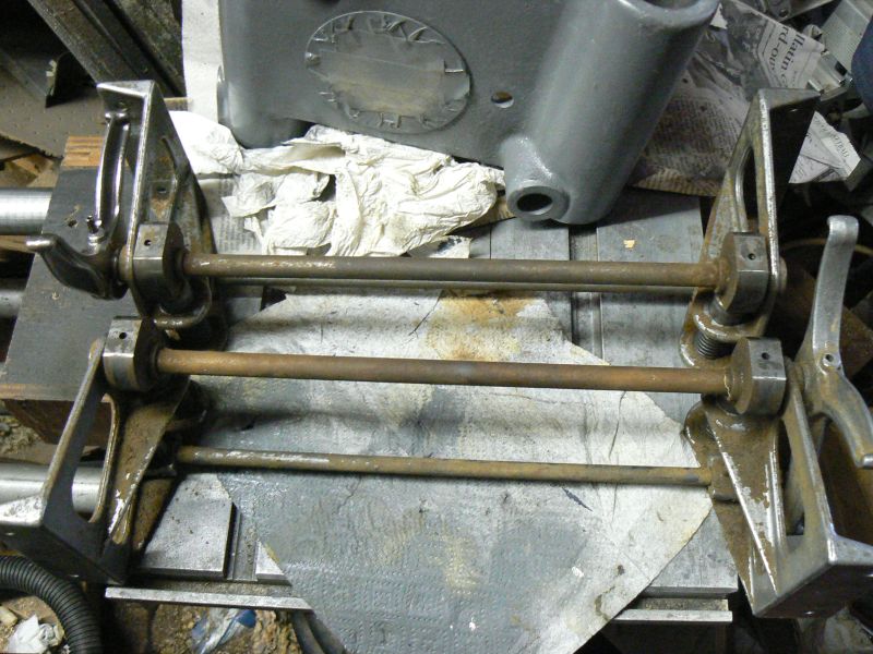

[ATTACH]8217[/ATTACH]
It seems to me that the 'top' caster set has the cam shaft reversed right to left. (or the same for the bottom one)(they should be left right pair)
Opinions PLEASE!!!

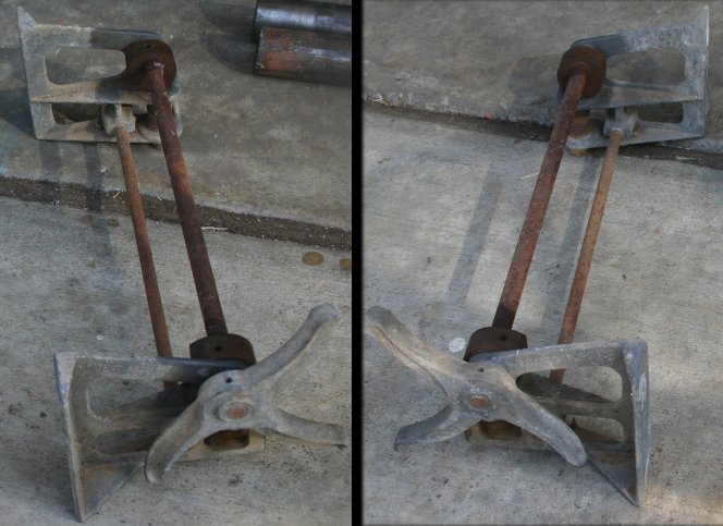

Left and right are mirror images of each other. Here's mine. I combined them into this one photo.
[ATTACH]8218[/ATTACH]
If this is how you got the unit, it would have had one lift pedal on the front of the unit and the other in the back (in err).
Sunny San Diego

p.s Did you drill through the other side of the casting to give yourself a through hole or did you leave the original blind hole?
Sunny San Diego
mickyd wrote:Left and right are mirror images of each other. Here's mine. I combined them into this one photo.
We agree! I did not notice the pedal front/rear flip. I believe it had two identical assemblies. Either one was reassembled in error, or somebody had two sets and got them mixed up, or somebody really wanted them that way. Obviously the one with the blind spring pin bore was not disassembled b4.
Thank you for verifying my 'conclusion'.

mickyd wrote:p.s Did you drill through the other side of the casting to give yourself a through hole or did you leave the original blind hole?
I drilled through the spring pin from the 'open' side. I then flipped it and enlarged the new bore to the size of the original bore.
The pix above(below the happy dance) is the NEWLY drilled hole. The pix shows the former blind end of the pin.
