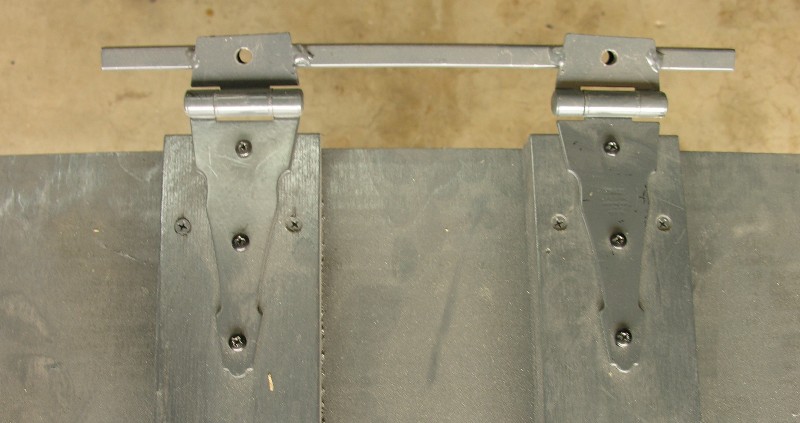

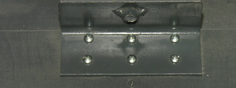

For the folks that want to build their own out-feed (Mark V 500) table I just found some of the component pics of one I built.
ldh
[ATTACH]8849[/ATTACH]
[ATTACH]8850[/ATTACH]
[ATTACH]8851[/ATTACH]
[ATTACH]8852[/ATTACH]

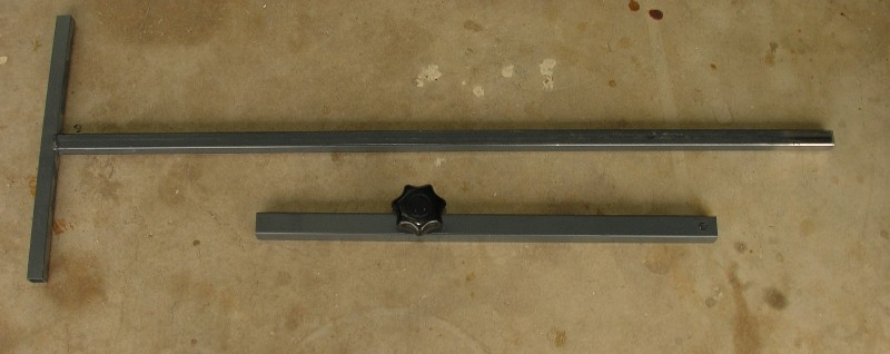

Out-feed table pics.
ldh
[ATTACH]8853[/ATTACH]
[ATTACH]8854[/ATTACH]
[ATTACH]8855[/ATTACH]
[ATTACH]8856[/ATTACH]
