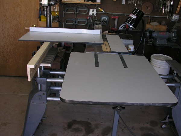

Post by ldh »
boostfan,
Try building one with your SS. With a bit of welding for the support leg and the attachment bracket you will find it an easy and fun project. You will end up with a table that meets your needs.
ldh
[ATTACH]8785[/ATTACH]
[ATTACH]8786[/ATTACH]
[ATTACH]8787[/ATTACH]
[ATTACH]8788[/ATTACH]

ldh,
Did you include a pivot lock on the outfeed table (top knob)? Nice job!
Rob in San Diego

Post by ldh »
SDSSmith wrote:ldh,
Yes, just a simple angle with bolt welded in for the leg to rotate on.
ldh

Post by kd6vpe »
Very nice work there. OK I will bite how did you attach the hinges to the main table? This look very sturdy and easy to setup thank you for sharing.

Post by ldh »
kd6vpe wrote:Very nice work there. OK I will bite how did you attach the hinges to the main table? This look very sturdy and easy to setup thank you for sharing.
Many, but not all of the 500 tables have a threaded hole (5/15x18) at the back end of each miter slot. A (5/16x18) knob holds the hinge bracket from the underside. Another member asked be about the bracket and I took a pic of it and sent it and when I can find the file I will post it. On some of the tables I have had to tap the threads. Check your table for the treaded holes.
