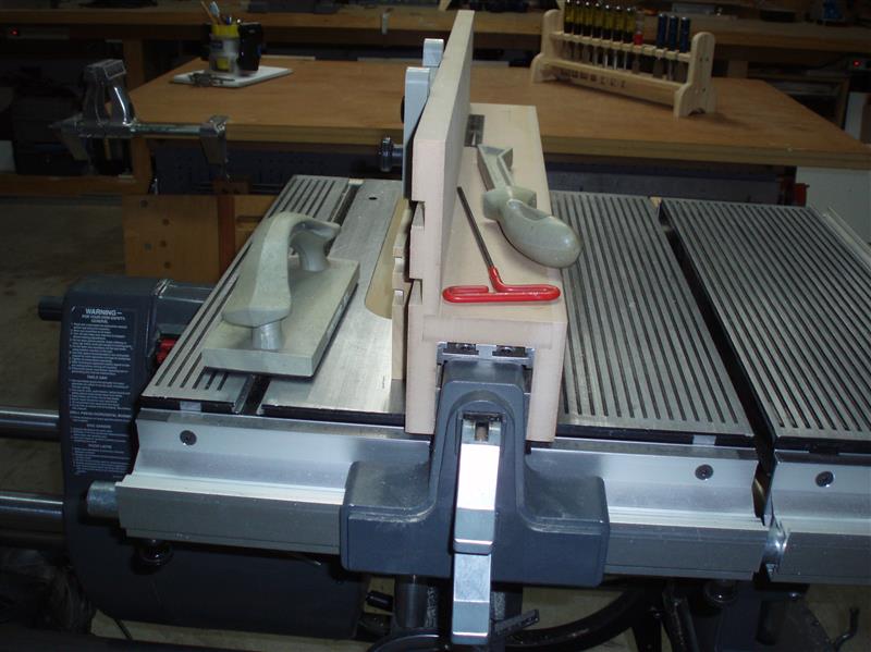

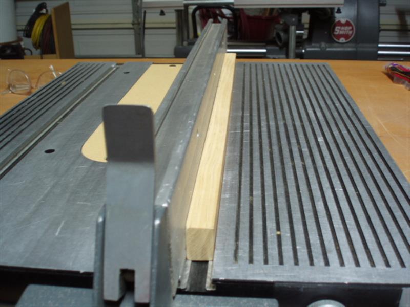

So if your rip fence resembles this:
[ATTACH]23894[/ATTACH]
and does not look like this:
[ATTACH]23895[/ATTACH]
then you do have a Mark V Model 510.
