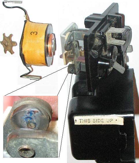

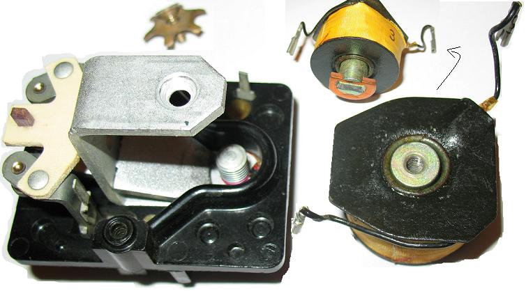

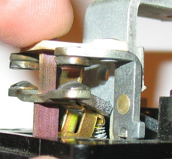

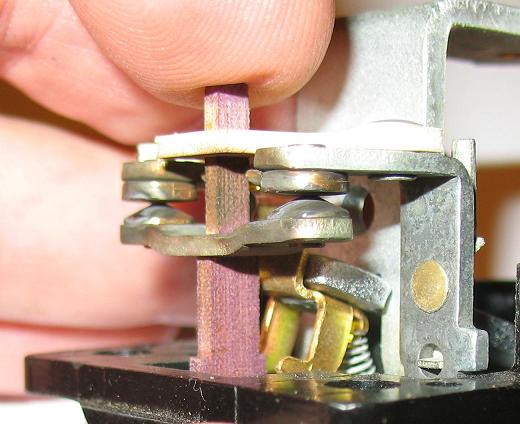

Well it's open now; "how?” you ask.
Simple, I took the mounting bracket off with style and grace to reveal 2 screws holding the thing together. It fell apart without a hitch.
The innards’ consist of a normally closed switch (contacts, spring and lever) and a solenoid. The coil of the solenoid has a dc resistance of 3.25 ohms. The contacts on the switch are charred a bit, but can be cleaned. The spring is weak but functional. There was sawdust inside the “black box” which cleaned out with no problem.

I would be inclined to burnish the contacts(clean oxide off) , put it back together and forget about an 'equivalent'. The presence of sawdust is a likely suspect! After several on/off cycles, I predict it will be reliable. Those contacts look almost brand new(albeit oxidized).
BTW which terminals is the coil connected to(1,5)or(2,5)?
I do not understand the resistor/copper/aluminum sentence.
The coil is across pins 2 to 5 (3.25 ohms)
The switch is across pins 1 to 2 (zero ohms)
I'll take your advice, for now cleaning it up and putting it back together is best.
I can look for an 'equivalent' in my spare time.... if and when I get some.
I'll let you know if the intermittent start-up problems go away after getting it all back together.

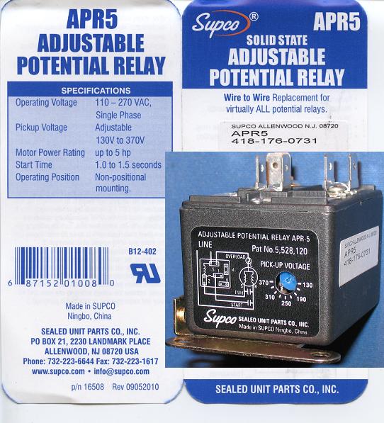

Ok.... spare time found last weekend.
The intermittent start-up problems did not go away.
Looked online for a while and found this adjustable potential relay.
It's solid state and is advertized to have a pick-up voltage range between 110 - 270VAC.
I didn't get the chance to wire up the new part until now.
Since this guy is adjustable - it was worth a try.
[INDENT][INDENT][ATTACH]11554[/ATTACH][/INDENT][/INDENT]
Hooked it up, powered up the Mark VII motor, and shazam ! I'm back in business
Actually I did play around with the potentiometer to see what effect it has.
The higher settings still work, but the motor doesn’t want to fire up so fast.
The lowest setting seems to work best since the motor starts very quick.

Grrrrreat!!! $????
Supco APR5 Adjustable Potential RelayJPG40504 wrote:Grrrrreat!!! $????
http://www.amazon.com/Supco-APR5-Adjust ... 811&sr=8-1
$25 bucks plus shipping
