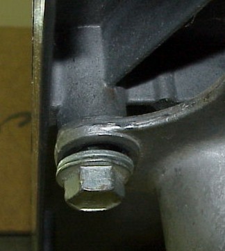

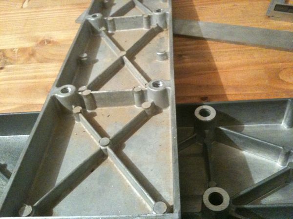

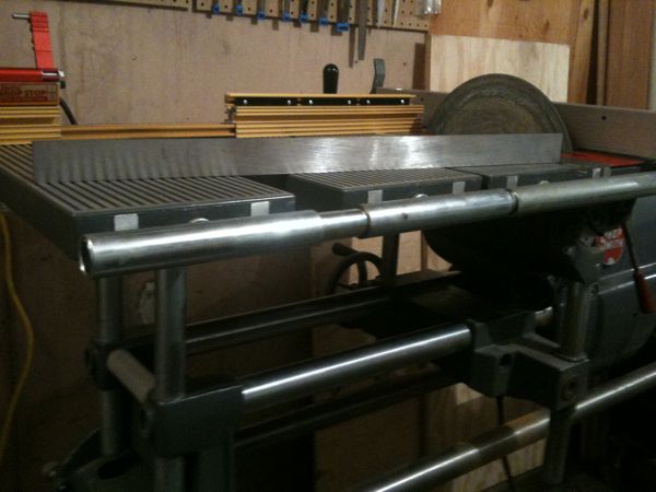

Sorry to keep firing off the questions, and I hope I'm not overstaying my welcome, but one more quick one:

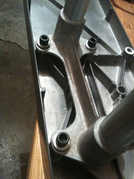

My 500 side extension table down-tubes bolt straight into the threaded holes.
[ATTACH]11527[/ATTACH]
But, well, these holes are not threaded.
[ATTACH]11528[/ATTACH]
Should I ask someone local to tap those holes? Or is there a part I can order to fit these down-tubes? Or should I just leave good enough alone, have a beer, and go to bed early?
EDIT: Hey pennview, I may have said it a few times, but for clarity, I also have basically NO play using the four inside bolts on each floating table. The only wiggle room is with those bolts all tight, and the thumbscrews loose. In that case, my main table allows the extension tube to "jiggle," but the extension tables have very little of that "jiggle." So in my semi-success post, I hold the floating table up against the main table while tightening the thumbscrews.
I doubt ss has main table rails to match the floating table rails. More likely they will have floating/aux table rails to match the main table one you have. That would give you the less desirable(newer) 'set'!:( You may be talking to the wall on this subject!
The floating tables do not have a need for the support post, therefore the holes are not tapped. The holes can be tapped, but a stud rather than the bolt allows greater flexibility to adjust the table alignment.

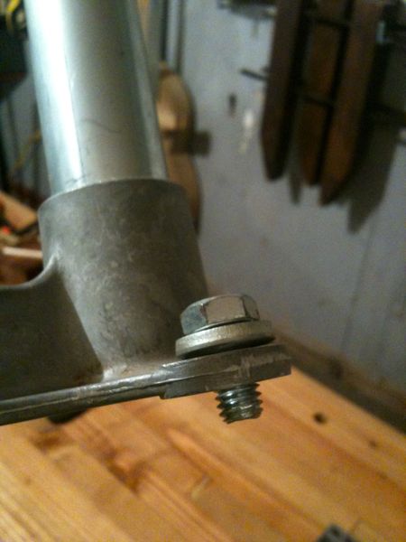

Double update for tonight:

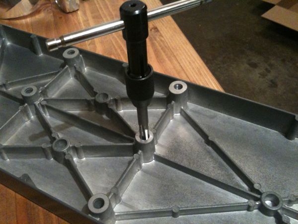

1) dusty, I didn't quite understand your suggestion on the down-tube setup. Not sure if I was clear, but all the holes in the bottoms of my floating tables are un-threaded. Maybe your bolts are unthreaded on top?
Anyway, I went ahead and tapped the holes, and I'm happy I did. Pretty easy down-tube installation:
[ATTACH]11561[/ATTACH]
Oh yeah, got some different bolts that seemed more "SS appropriate" to me.
[ATTACH]11562[/ATTACH]

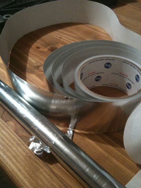

2) I'm not willing to give up on the quest for reasonably even-height tables. I was thinking along the lines of the wedge or shim idea mentioned here. Wandering around the hardware store, I found some tape made of metal... seems promising.
[ATTACH]11563[/ATTACH]
I figured I'd just wrap until the OD is fattened up enough to be snug in the main table. Problem is, there's some metal imperfections inside the tube, around the edge of the thumbscrew hole. This was TOO snug, and ended up tearing up and jamming the metal tape.

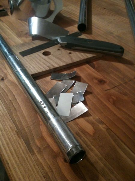

Plan B: more like the wedge idea, I figure the shim only needs to be in the direction of the problem.
[ATTACH]11564[/ATTACH]

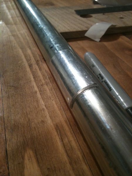

So here's a bunch of very thin, sticky metal shims, right?
[ATTACH]11565[/ATTACH]
After a few, I start test fitting it every couple strips. It takes 10 for a pretty good fit, 12 for snug.
Needs some fine tuning, but I don't see any immediate problems with this. Tables are all level without fiddling with the thumbscrews. Loose or tight, the z-axis needs no by-hand adjustment. I don't like the idea of the thumbscrews maintaining the z-axis position -- they're clearly not made for that, and I can't imagine them being good at it.
[ATTACH]11566[/ATTACH]
Well, it's close, at least, and I think I can get it perfect with this method. Other than the pipe now having an artificial top and bottom, and the less rugged surface of the tape, does anyone see any problems with this plan?
Thanks again for the help and encouragement everyone!
