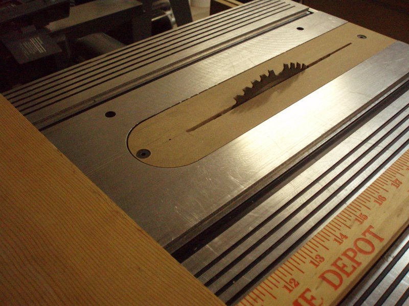

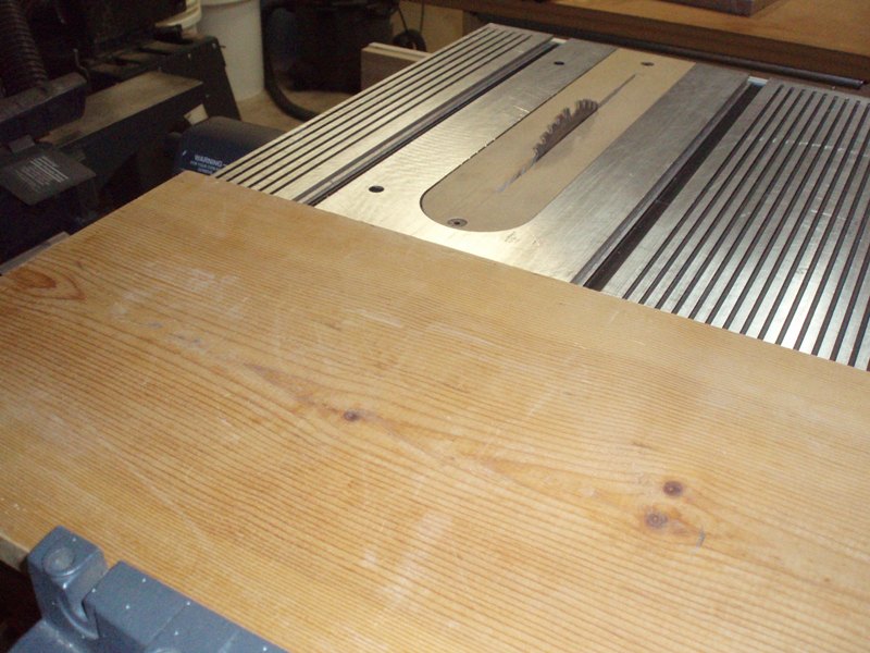

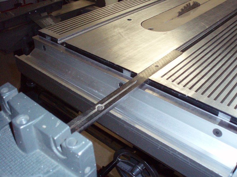

BigSky wrote:An indoctrination Please. What makes the t-slot feature so very valuable. Most tables saw that I have used don't have a t-slot either.
Bigsky: There is some value brought about by the t-slot. It serves as sort of a virtual extension of the table in which it is being used. In the case of the table saw, it allows some stability when attempting to cross cut larger pieces (say 15"-16").
[ATTACH]12301[/ATTACH]
[ATTACH]12302[/ATTACH]
[ATTACH]12303[/ATTACH]
I try not to do what is depicted in these images because it can lead to some binding (kickback) if not done carefully. I am enough of a klutz without pushing the envelope.

dusty wrote:Bigsky: There is some value brought about by the t-slot. It serves as sort of a virtual extension of the table in which it is being used. In the case of the table saw, it allows some stability when attempting to cross cut larger pieces (say 15"-16").
Bigsky: Notice in Dusty's pix there is no way to attach a front table extension to the 505-20 tables. The washer prevents the miter gauge from dropping down when 'hyper-extended'. Not as stable as the M5/500 extension, but better than none!
One caveat - when the washer is removed, the bottom outer edges of the washer counterbore can be very uncomfortable when grasped in that area(especially a 'sliding grasp'). Sometimes even with the washer!:eek:
