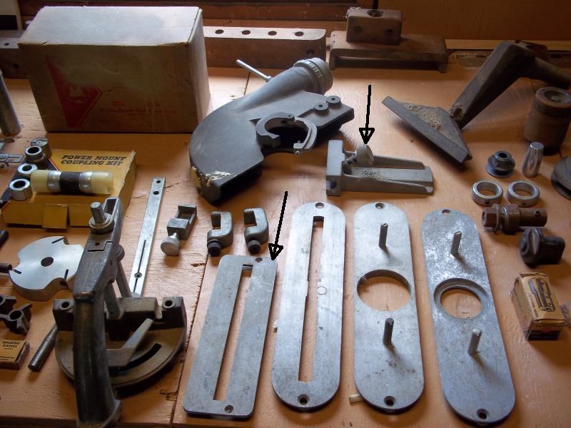

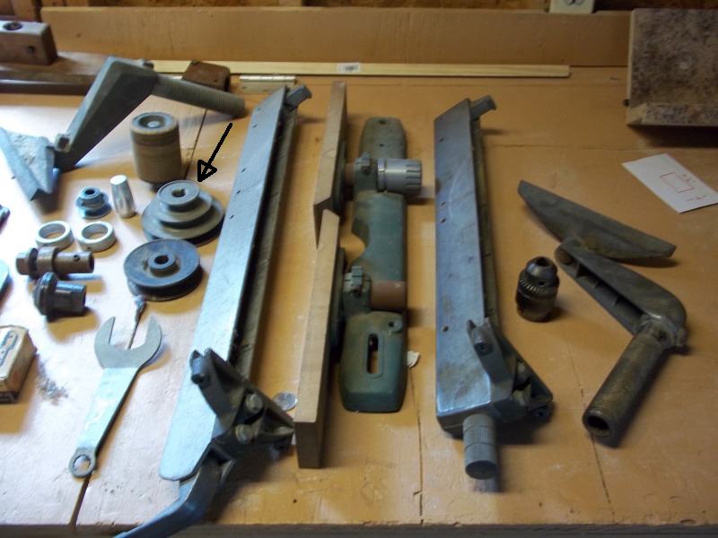

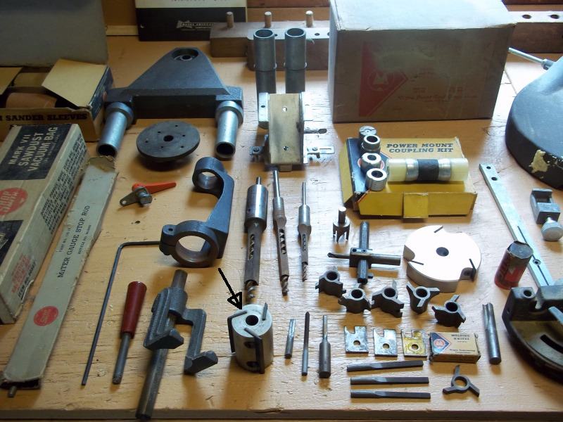

jayp413 wrote:Being "new" I was wondering if you could tell me which parts you believe to be for the 10. Any help would be appreciated. I know poppi was asking about the fence.
[ATTACH]12930[/ATTACH] 2.5" Jointer head
[ATTACH]12931[/ATTACH] Front table extension, table insert
[ATTACH]12932[/ATTACH] Motor pulley(?)
The fences are Mark 5/V and VII.

There is a Mark VII clutch handle/lever in this photo with the little red handle and a Jointer Cutter Head in the foreground.

As I look at your treasure trove of loot I noticed that you also have a set of files for your jigsaw. They can be hard to find. Also the jointer head mounts on the quill without any kind of arbor. Used with the shaper fence, you can do some light jointing.
