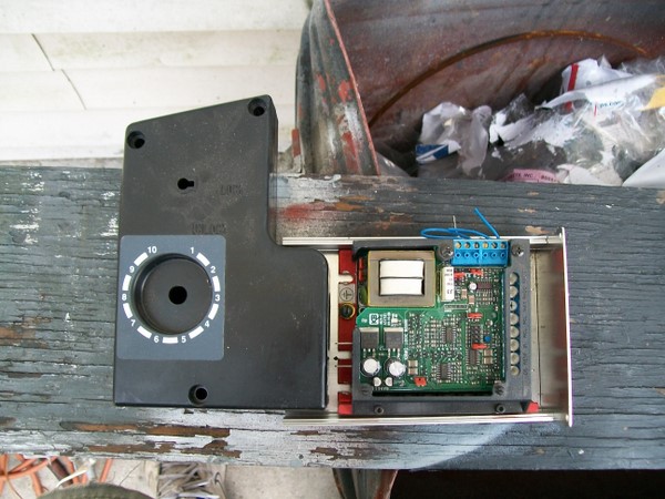

Almost a fit. A future project for me. Putting the controller box below the Feed motor would help protect the box. The smallest box that will fit the KB controller is about 1/2" taller than the right side of the planer controller and 1/4" deeper. I would saw off the planer box end (power to the Shopsmith headstock) and move the sawed off part to the end of the new controller box. I would use JB Weld to connect the existing and new boxes. I would use double sided tape to attach the new box to the planer. This mod would also fit on the scroll saw.gpmark wrote:Bill,

[ATTACH]13563[/ATTACH]
- 100_0313.JPG (85.27 KiB) Viewed 2613 times
Good feedback!
Couple of thoughts in return:
1) which controller is that you're showing?
2) after a bit of thought after reading your neat idea of sawing off one end, I think I would prefer to make the extension out of plastic channel. Take of the end, use right angle aluminum or pvc glue sticks to attach the channel to the sawed of portion, ditto to reattach the sawed off piece, and two pieces to attach a top. Channel comes in many sizes of pvc and can be cut to fit.
3) I think I would also prefer to tap the cover and put a bolt in the new section to attach it.
Probably a month out before I try anything, but it's really good to talk this through with someone else!
