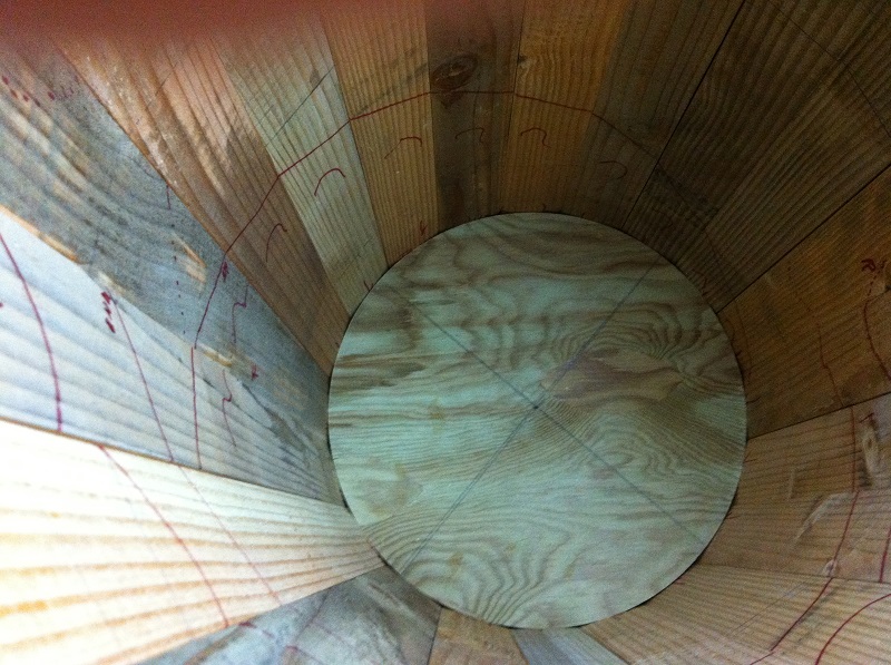

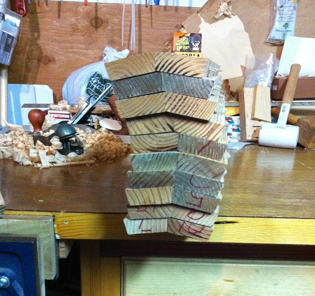

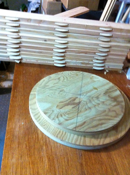

I just about finished a project that used my biscuit joiner for its first serious project. A cylinder: 20 'staves' (or "sides") at 2-1/4 x 23 x 3/4, 3 biscuit slots each edge for 120 total, from a 2x8x96 pressure treated rough sawn board sliced up on the band saw to width and length, only "finishing" knocking down a stobborn knot or few with a hand plane.
Calculated inner diameter with my CAD program (11.841"), cut discs (home made Band Saw circle cutter) of 3/4 Exterior CBS plywood (CBS= Crappy Both Sides) to that dimension for ends, assembled biscuitted pieces around it to check fit, and 'low and be holed', not one proud edge in the whole lot. Only fitting was again having to knock down, in the edges, not faces, some knots that had crept back out (bulges in edges).
Cutting the slots in the workpieces was a tad troublesome because I was pushing a 9 degree slope into the Joiner, not a plumb edge, but with a very minor "aid" and a little care pushing in to engage the pins before tilting up to mate edge with fence and then pushing thru, it was not difficult at all. Just took a little longer.

Btw, I used #10 biscuits, from SS of course, and tho a few were tighter than most, none refused to go into the slots. Imh(and uneducated)o, they seem to be of very good quality. As does the whole unit. Easy set up & alignment, easy use, clean and superbly accurate cuts and excellent chip/dust extraction.

This will be an interesting glue up. Since the inner discs will be making contact only at one small spot per stave, I'll be using some of that Gorilla Glue type stuff for them that activates with water. But first the staves have to be glued together, with regular exterior wood glue. And I can't do em all in one shot- glue sets too fast here. Then its pop the discs, one at a time, wet their edges and wet the staves, brush on the Gorilla juice and hope to get the disc back in place before the Gorilla starts to swell-- this stuff expands, a lot, as it sets. Another ply disc will cap each end, up against the smaller disc. Large quantities of Gorilla product will be involved in this step as well. And its the expansion I'm counting on to seal the cylinder ends.
