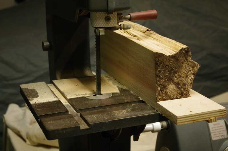

Meantime, Rick's sawmill is in business:
[ATTACH]15288[/ATTACH]
Shopsmith Sawmill.JPG (312.42 KiB) Viewed 1882 times
chipmaster wrote:I saw those "new and improved" ones but didn't really have any basis for judgment. Has anyone tried those and, if so, what's the difference?
$29 comes to mind!
Nice rescued fire wood!:cool:
