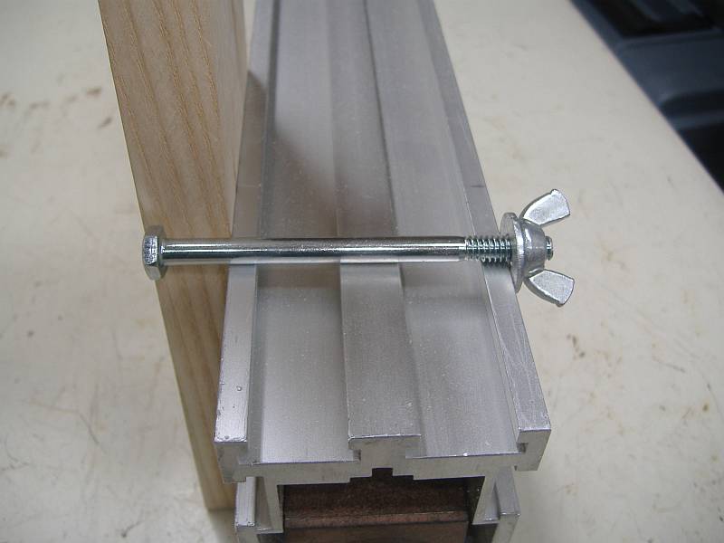

To better give you an idea of just how wide the fence is take a look below where I have a 3/4" piece of oak next to the fence and then a 3-1/2" bolt which would be required to use a "hole" mount.
[ATTACH]16047[/ATTACH]

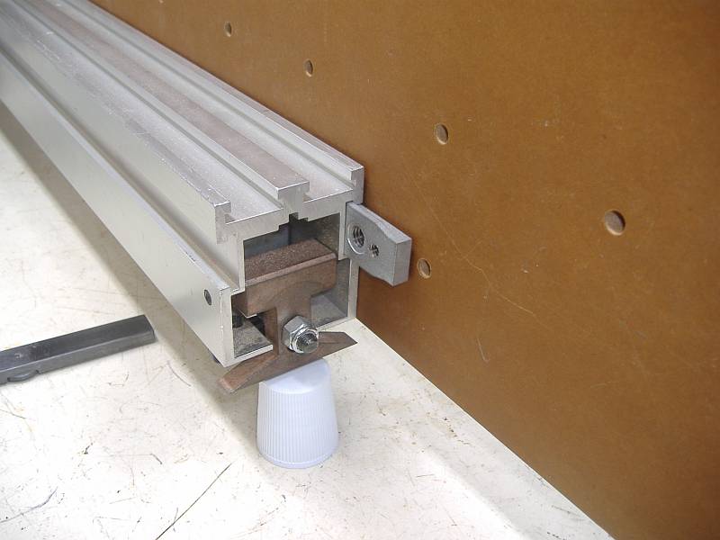

Next is a picture of one of my fences that I leave a set of t-nuts on. In fact most of my fences have the t-nuts in place because it just so easy to slip them in place and tighten.
[ATTACH]16048[/ATTACH]

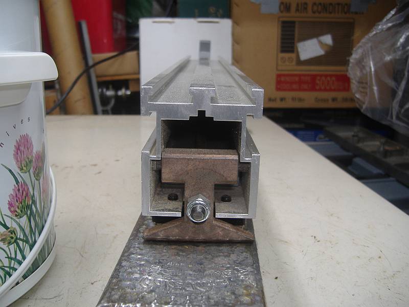

Of course some still might want to "drill" them but where do those holes go?
I guess the t-slots could have holes in them??? Fender washers??? Wonder how easy the second hole will be to find???
[ATTACH]16049[/ATTACH]
There is some room between the t-slots and the rod inside the extrusion lower down near the main table... yea I guess you could fit them in but it sure wasn't designed for that.
