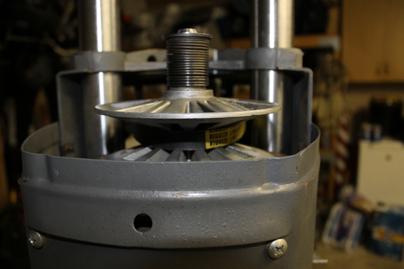

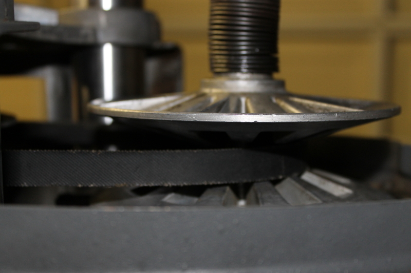

Here is the current belt position on the motor and fan sheaves.
[ATTACH]16201[/ATTACH]
Another pic from under the motor of the same Motor/Fan sheaves.
[ATTACH]16202[/ATTACH]

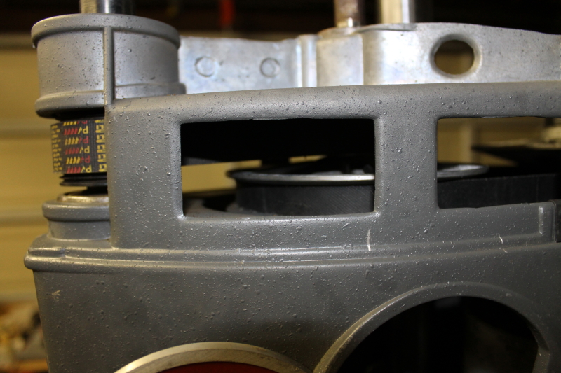

Current position of the belt on the control/idler sheaves.
[ATTACH]16203[/ATTACH]
I have 2 more pictures for the next post....

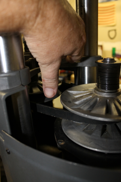

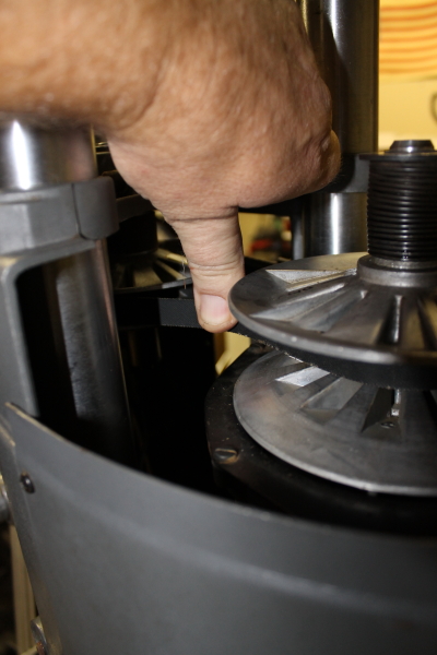

Ok here is a shot of the belt relaxed as it sits today. The far side is against the way tube.
[ATTACH]16204[/ATTACH]
Same shot but this time my thumb is attempting to push on the belt to show how much it deflects.
[ATTACH]16205[/ATTACH]

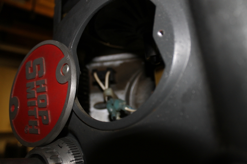

Finally a shot of my power switch from the inside. No matter how fotog crazy I get with settings, I'm having a hard time shooting through the opening and getting a clear sharp image. Sorry.
[ATTACH]16206[/ATTACH]
John
