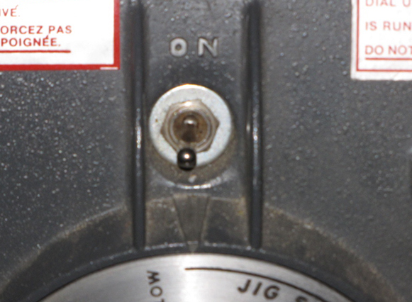

Here is a picture of my toggle switch ...
I bought new and it was marked on the bill of sale in Oct 1988 as a Mark 510
The label says Mark V model number 555510 and then the serial number.
Does it makes it a A - B or C
Camerio
MarkV 520 & Band saw
camerio wrote:Here is a picture of my toggle switch ...
FWIW The switch depicted here is, by way of thinking, set at 6 o'clock. In this position, the Mark 5 should be "OFF".
If it is not, loosen the nut that holds it in place, rotate the switch 180° and reinstall it.
I don't have an example of this headstock to look at. Is there any sort of retainer that keeps the switch from rotating in its position.
camerio
Posts: 602
Joined: Fri Aug 11, 2006 8:01 am
Location: Valcartier, just north of Quebec City, CANADA
Post by camerio »
No, no its alright, it is in the right position and the machine is off in that position.
I am just trying to comprehend the A - B and C head stock, that's all.
Camerio
camerio wrote:No, no its alright, it is in the right position and the machine is off in that position.
Take a good look at the last pix in post 22. That is an "A" headstock.
Yours is a "B" headstock.
Notice the top of the speed control circle is cut away on the "A" headstock. That cutout allows the interlock plate(seen in the greenie pix in the same post) that is mounted under the switch nut access to the back of the speed indicator dial. That plate must be depressed to adjust the speed above saw-joint.
The "C" headstock has the square hole mounted safety switch with the removable actuator.
P.S. Both the "A" and "B" headstocks have protective ears to the sides of the switch. They prevent inadvertent turning on, but allow the switch handle to protrude above the ears for easy turning off. So up is on, down is off. Later " B" castings have holes in the ears to allow locking the switch off.

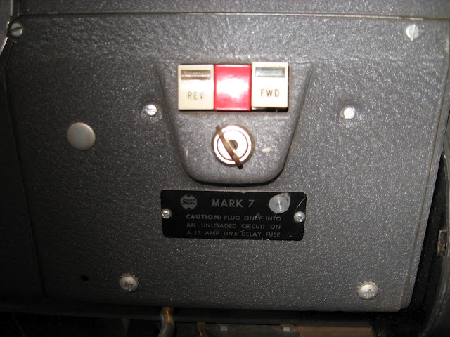

Not to complicate things but just to have similar information in one spot here is the switch (with locking key) from the original Mark VII:
[ATTACH]16438[/ATTACH]
I also have one of the accessory locking switches (separate utility box) that I took off of one of my Mark V's. I don't find a pic of it and it is not where I am right now. I'll try to get a picture of it later.
Added note: I believe most (if not all) of the import knock-offs had a push-button switch down low on the headstock.
Mark VII key and switch.JPG (93.52 KiB) Viewed 2037 times
Do the reverse and forward keys connect to relays that actually do the power switching OR is the power switching accomplished by the switches.
I really wonder why this feature was abandoned in the transition to the early Mark 5? I never read about owners having power switching problems which leads me to conclude that it was not a reliability/dependability issue.
Now, think about it. If they had carried that reversibility feature through, half of the PowerPro's thunder would be lost.
It also seems curious to me that of the three motor manufacturers, Emerson's is the only one that is not reversible. They had to design in the non-reversible feature.
