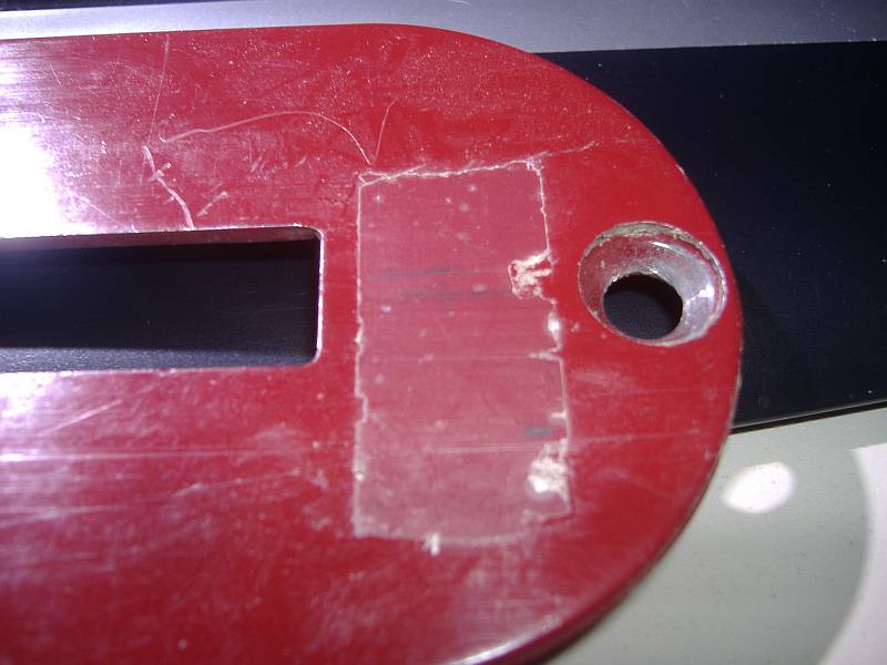

Now here is another post I don't feel like trying to find so I try and cover it here. I like to have a mark were the edge of the blade cuts as a reference. This can be done with magic transparent tape. I'll post a couple of photos to give you the idea from here at my computer, too cold to work in the shop now (39.6 degrees).
You simply stick the tape on the insert, then run a scrap of wood (say 3/4 x 3/4 by 12" through the blade, keep holding the stock against the miter gauge and don't let it move. Now slide it back to where the tape is and mark. Move the miter gauge to the other side and do the same thing. Now you have both sides marked. Just remember to change tape and marks when you change blades... just another think I've been doing for more then 50 years now.
[ATTACH]16173[/ATTACH]
BTW you could add a special circle in your home made inserts that could be replaceable that you could score lines on as you go.

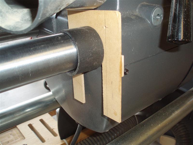

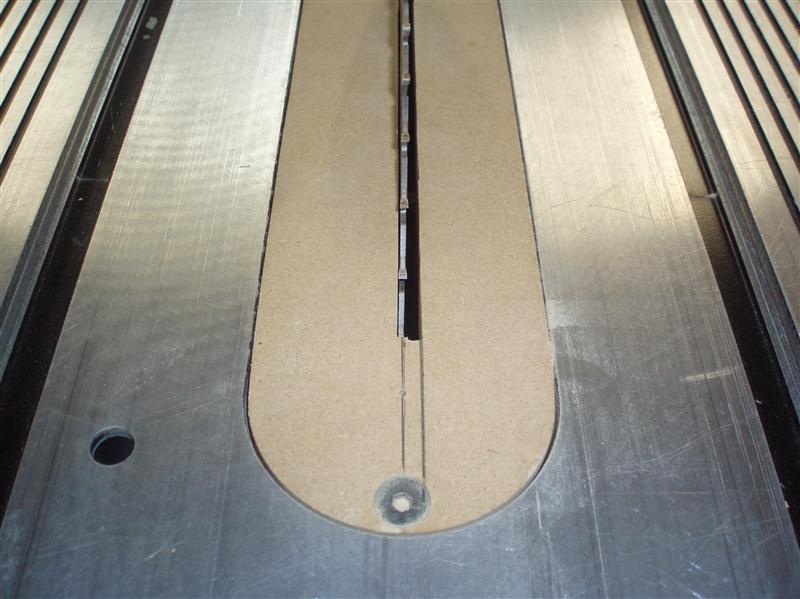

What got me started on this centerline issue is not a matter of thousandths. My centerline is off 3/16 of an inch. It is, however, quit repeatable ( to within .005").
Saw Kerf with respect to Insert Centerline

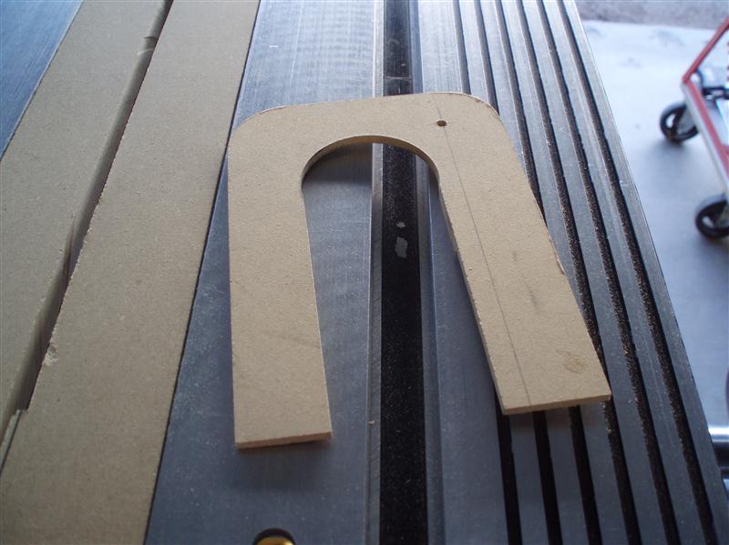

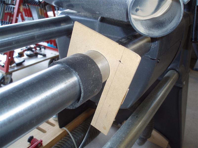

The solution (at least the initial one) was just too simple. It is called a spacer. Actually it is a supplement to the rubber carriage spacer ring.
[ATTACH]16174[/ATTACH]
This picture shows the centerline, the original offset kerf and the kerf cut with the supplemental spacer installed.
[ATTACH]16175[/ATTACH]
[ATTACH]16176[/ATTACH]
This picture shows the solution in place along with the carriage spacer ring.
[ATTACH]16177[/ATTACH]
This will be "it" for a while. If this proves to work, I will build a "final solution".
UNLESS - the new carriage rings are wider.
I believe I will wait to cut the kerf in the new ZCIs that I built in conjunction with the ZCI sled project. I should probably also wait to recut the ZCI sled kerf.
